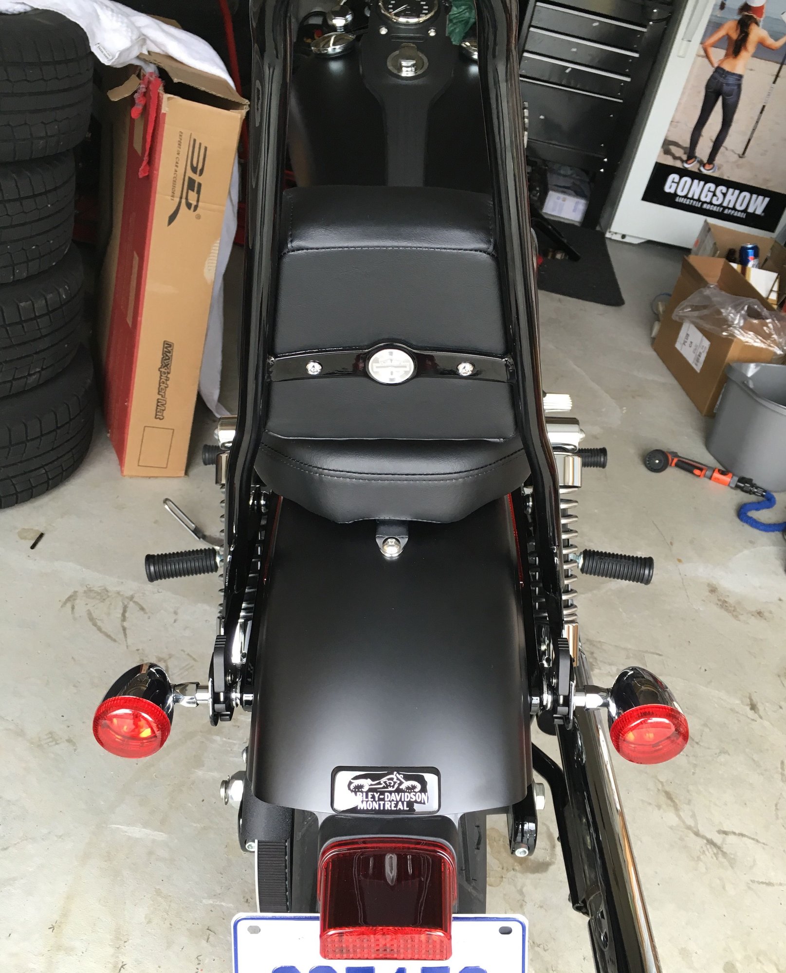

I don't know if this is what you are looking for but here is a pic of 16 streetbob with the detachable sissy bar, still using signals at the same place thx to the kit
