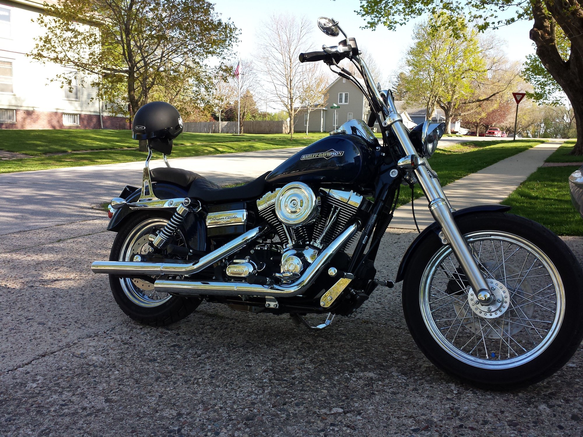

I put minis on my 2012 FXDC with all stock cables. Had to reroute the clutch to come up from under the frame on the right side and cross over in front. Zoom in and you can see in pic below.
