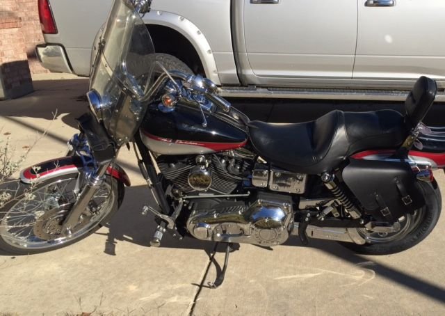

I was in the same situation with my 01 wide glide. I ended up with a single side bag from Bad&G. I am really please with what I got. Check em out at www.badgcustoms.com/
They mount to the fender strut with a leather strap.
