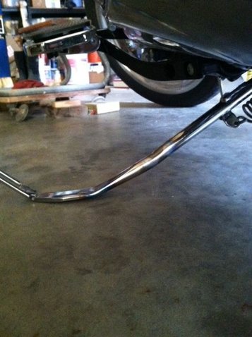

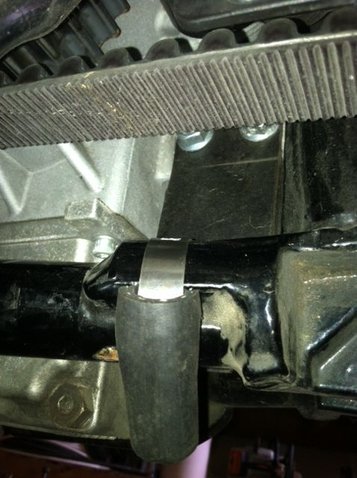

Lots of good options for the short Dyna sidestand, including welding onto the lock tab, and adding a plate to the bottom. I also read the suggestion to get an early 90's stand that is more straight. So, I got one. Two main problems with the early kick stand are that the bend right at the pivot block was way more than 90 degrees, AND the overall length was less, meaning no improvement. So, with my stand off the bike, I heated and bent in two places. Straightened the main bend, and then added to the bend in the foot so it would sit flat. The chrome discolored, and I was able to polish it back a bit. But, this certainly now has the bike sitting properly. Only problem was the rubber bumper....now misses it by a mile. Removed the original, and built a new one from 1/2 inch black hose, like heater hose. Cut a slot, used a 2 inch clamp to secure a section of the hose to the frame just behind the original bumper location. Works fine and cannot be seen from the side. A short side note on heating and bending. Most of these steels are alloy, meaning not plain carbon steel, maybe just a nickle chrome moly that can be hardened easily. But, when I heat to about 1400 red, then bend and allow to cool, it has no heat treat hardening, yes. But, this section of side stand would hold up my truck, let alone a 700 pound bike. I would be curious to know how they build parts like this one. Heat and bend to shape. Heat, quench, then reheat and temper. Or, perhaps the steel is so strong they just use as is with no heat treating after the bending and shaping processes.

I always have to laugh at some of the comments. There are a ton of folks who have discussed and tried solutions to the bike on its side, and those of us who have lived on bikes occasionally have found ourselves having to park on soft ground, etc. With the excessive lean angle, my opinion after more than 50 motorcycles and 50 years of riding, I wanted a change. I am not suggesting that the minnesota riders association modify all of their bikes, nor that the moco take any action....another fantasy. I
f my pictures attach, you can see that I still need to get some blue remover. The angle changed about 5 degrees and the handlebar height went up about 1 1/2 inches on the stand at full left.
