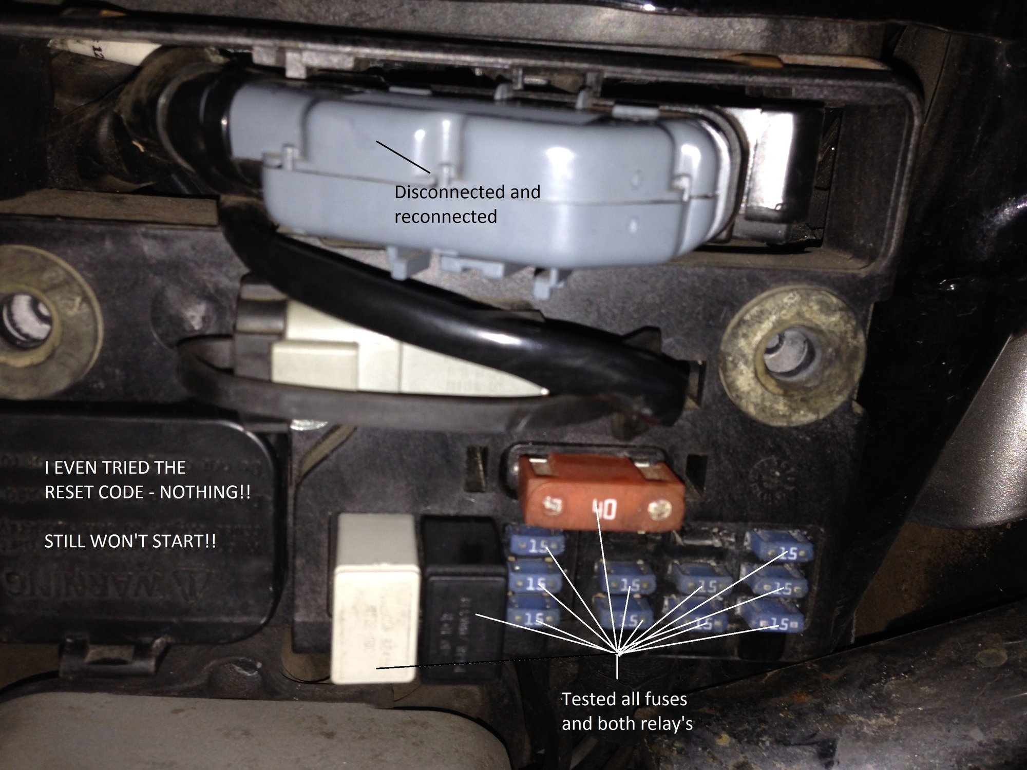

I started my Harley the other day after it had been sitting for a while. I decided to rev it to blow the cobwebs out so to speak. There was a shot of flame out of the bottom pipe then the engine died. I haven't been able to start it since. It turns over but doesn't ignite. Have I done something catastrophic to it??:mad

It is a 2006 Dyna Superglide Custom, fuel injected (EFI), no mods, no gas stabilizer, plugs have only just been replaced as has the suspension. It's just had its 50,000km service. It sat dorment for about 3 - 4 weeks not being started.
I have removed and tested all fuses including the 40A master fuse, both relay units, inspected the spark plugs, brought a new battery. I even tried the reset codes - nothing mate.

Confirm the basics: fuel & spark.
Can you hear the fuel pump when you hit the switch?
Confirm your plugs are sparking - pull one, put the cable back on, hold the body with a pair of pliers and hold the plier end against the fins on the head while you crank the motor.
Check to see any sensor wire are firmly attached ( crank, oil... etc).

You might have the 300 buck fuse prob I had once. Similar prob, turned out the instrument fuse was blown. I coulda sworn I had checked it along with the rest. 280 clams for a roadside rescue and 20 bucks fuse and labour cost I was going again.....
