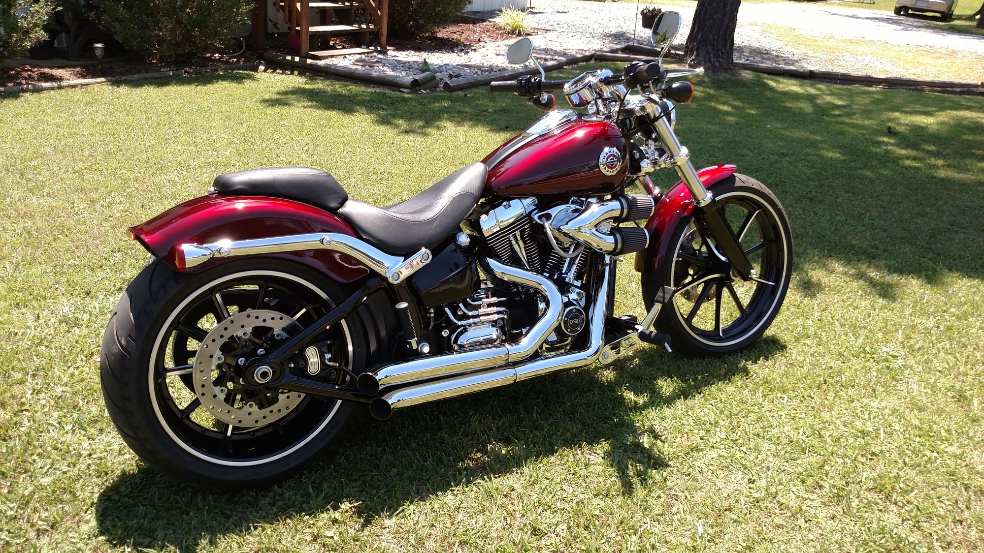

I like the simplicity of the screaming eagle or k&n air cleaner! I have the rain sock on it in this pic!
