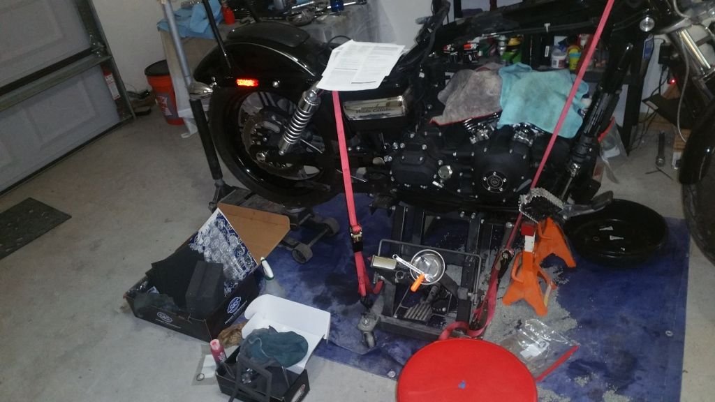

Installed ROCKOUT rocker shaft inserts
http://www.rockout.biz/
Amazon Amazon
i didn't understand why there were 5 sleeves. but i thought about it and i get it. because people fk up. that really considerate, thank man
blah blah
Rockouts on the dyna were way easier than on the sporty
done.

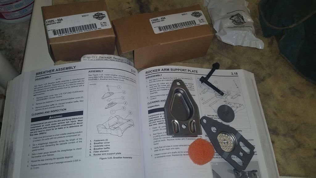

investigated the new breather assemblies since i have no idea how the go together
In my arrogance, i figured i already had a 1/8 drill bit.... i do not... will revisit rocker assembly later today.
