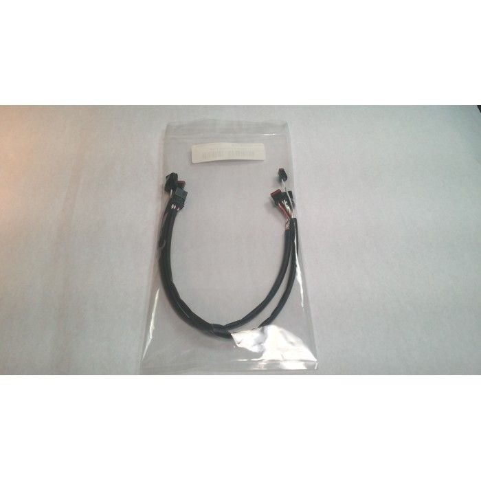

Listen to these people and get the extension kit, plug and play! It adds 15" of cable.
https://www.magnumshielding.com/wiri...ring-1015-sc14
