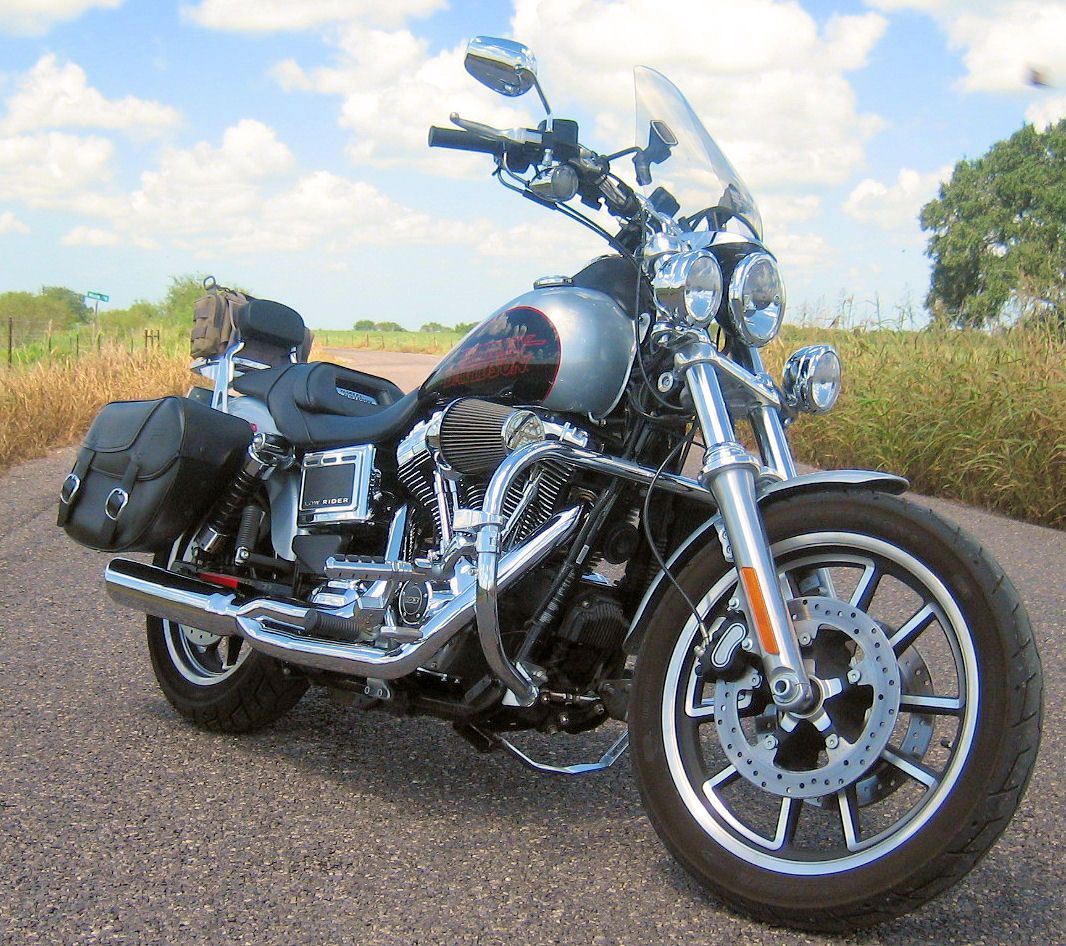

Pulled the trigger and placed an order at FuelMoto for a D&D Fatcat and Dynojet Power Vision w/ Target Tune. Keeping my fingers crossed that I can get the Fatcat and Low Rider with its mid-controls to work.
That is one good looking Low Rider you got there.
