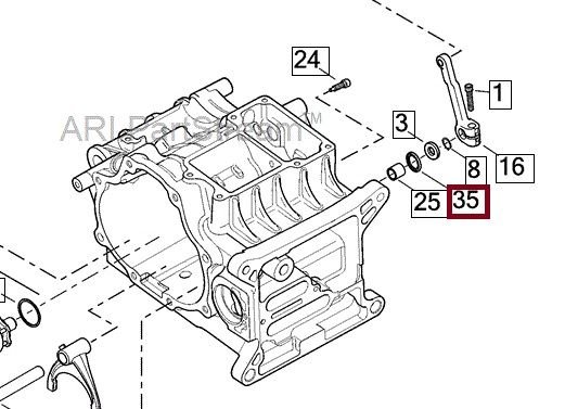

My thought is it's the inner primary seal. This can fail from a few different reasons. I'm chasing one on my '94 Ultra currently (see attached). I finally figured it's the bearing and it's causing a failure of the seal. I've also checked the main shaft race. It's within tolerance and spec.
So I'm going to have a new bearing and seal pressed in tomorrow and see what happens.

There is no shifter seal on a Wideglide.

True fact; but... the Wide Glide shares its inner primary with several other Dyna's and there is a #63869-06 gasket on the unused shift tower that's supposed to compress against the outer primary cover to prevent any leaks from the tower.
I do know I've started seeing oil weeping from behind my inner primary and I know it's forward of the transmission; I figure it's that shift tower gasket. When I pull the primary to do the Baker compensator and Attitude manual chain adjuster I'll find a better solution. I should just cut that stupid tower down and permanently block the back of the primary... Yay homologous parts...
Not in the primary. There is one in the gearbox, though!
