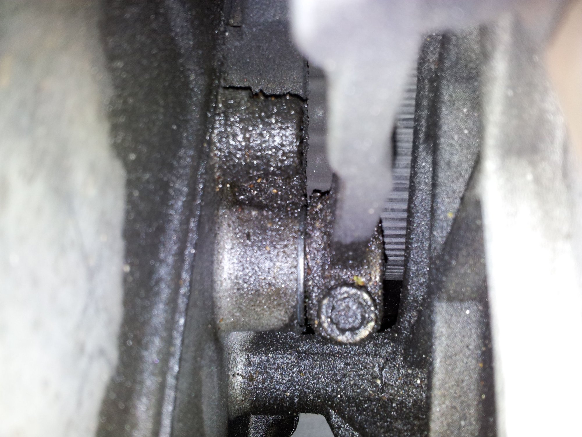

The drawing of the trans. case provided by FXD2003 shows an o ring seal that goes around the shifter shaft into the trans. Those will weep and slowly dribble oil out and then it gets blown onto the primary only to dribble down towards the case drain plug. Had that twice on my 02 FXD.
This is how it looks like when the shifter shaft has started leaking:
