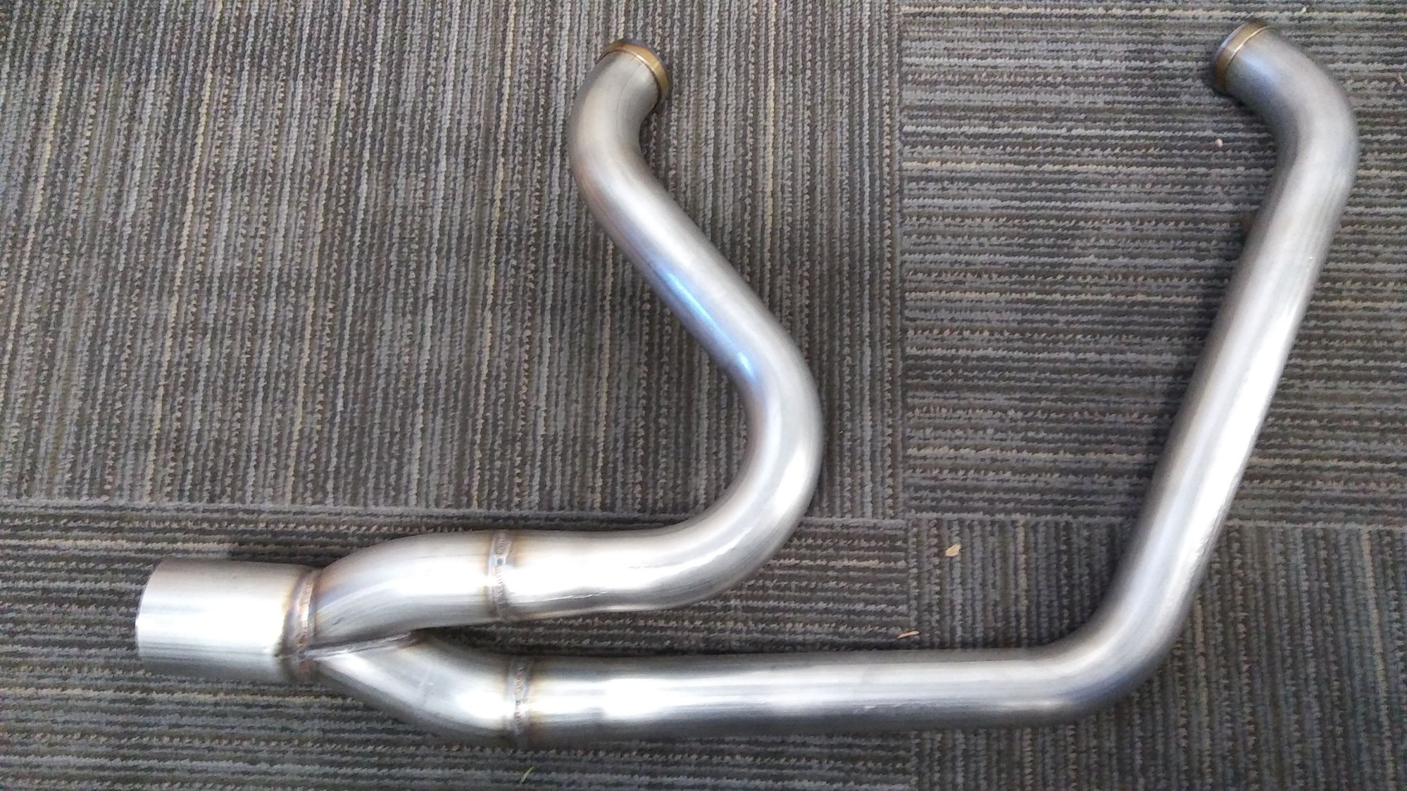

Hi eLBo,
There are two main styles of Harley header headpipes, one is conical like the factory exhaust, the aftermarket style is just a ring welded on the pipe that the retaining ring rests against. The factory system uses a conical gasket that matches the cone shape at the end of the pipe, the other style of gasket is flat and is used with most but not all of the aftermarket exhaust systems. the two types of gaskets are not necessarily compatible.
Who made the pipes have broken and what style were the headpipes?

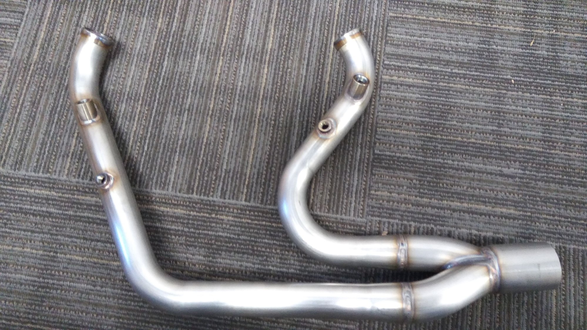

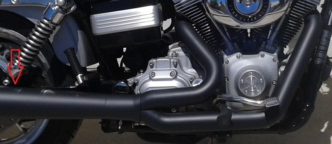

Old Jan 11, 2017 | 11:53 AM
eLBo's Avatar
eLBo
6th Gear
Joined: Jan 2017
Posts: 14
From: Sin City
Hopefully these will help. Sorry they aren't better pix. The red arrow in the last image shows the only other mounting point, aside from where it mounts at the heads.
Old Jan 11, 2017 | 11:57 AM
NORTY FLATZ's Avatar
NORTY FLATZ
Joined: Jan 2015
Posts: 16,023
Likes: 7,148
The muffler isn't "ridgedly" mounted to the frame is it? That won't work with a rubber mounted engine...at least for very long.
Old Jan 11, 2017 | 11:59 AM
eLBo's Avatar
eLBo
6th Gear
Joined: Jan 2017
Posts: 14
From: Sin City
There is a solid steel bracket that runs from the tranny bolts along beside the swingarm, that bolts to the muffler.
