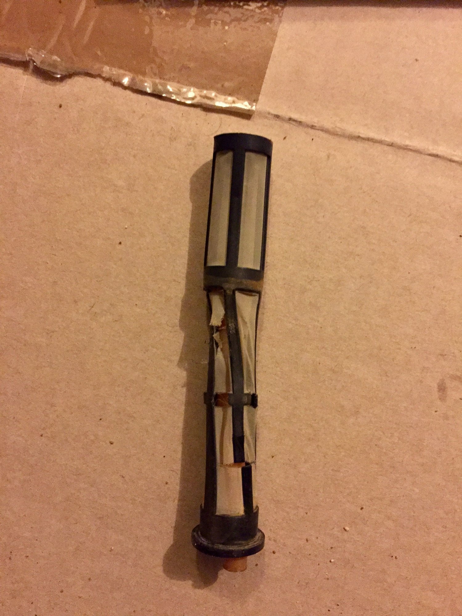

I'm installing a new petcock on my FXDX. This video at 5:25 makes it appear like the little fuel filter slides right out. Mine pulls about halfway and won't budge. Im yanking hard with two hands and nothing.
Am I missing something here? Is it connected to something else inside?

The petcock filter isn't connected to anything inside the tank, it typically just slides right out. I did have one where the filter screen had unraveled itself and needed a few tugs to pull it out of the tank.
Did you disconnect the fuel hose and the vacuum hose running from the carb to the petcock body? The vacuum hose runs from the carb to the petcock to open the diaphragm in the OEM petcock. I can't imagine what else could be preventing the petcock filter from sliding out of the fuel tank...

Lil f-ker was waaay stuck up in there. Some needlenose did the trick. Black Pingel arrives tomorrow.

Yeppers; looks pretty much like the one I had to get a bit wrathy with to get it out of the tank; good thing you are swapping out that petcock and the screen filter; that screen crap eventually ends up in the carb bowl. Nice job on going with the Pingel; I know they're a bit spendy, but the quality is so worth the price you pay
