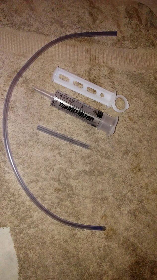

I just stumbled across that reverse bleeding procedure a couple weeks ago myself while researching the notoriously hard-to-bleed clutch on a 1st gen Miata. My son's dual disc Yamaha got a total brake rebuild last fall and bleeding that conventionally was a real bitch. I think the splitter/manifold on the lower tree was holding air. It doesn't have it's own bleeder and it's a bulky cast aluminum thing. I'd really like to try the reverse method to see if we can firm up his brakes some more. If it works, I'd also like to try it on my dual disc conversion on the DWG.
Can you elaborate on the syringe and any hose/fittings you used? Where purchased, etc?

I purchased the syringe from walmart, it's called The MixMizer.
https://www.walmart.com/ip/FloTool-G...Mizer/16889145
It came with a small piece of tubing but I had already picked some up from Oriellys. I couldn't say the specific size but it was clear fuel line and they only had 3 sizes. I picked the middle of the 3 sizes and it worked perfectly. Hope that helps.

Was the syringe big enough to completely bleed in one filling?

Yes it was, if it doesn't just close the bleeder valve then add more fluid to the syringe.
