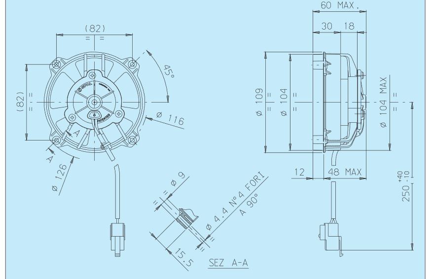

Something like 2 of these hung on a light tubular bracket...
https://webstore.spalusa.com/content...03009_SPEC.pdf
