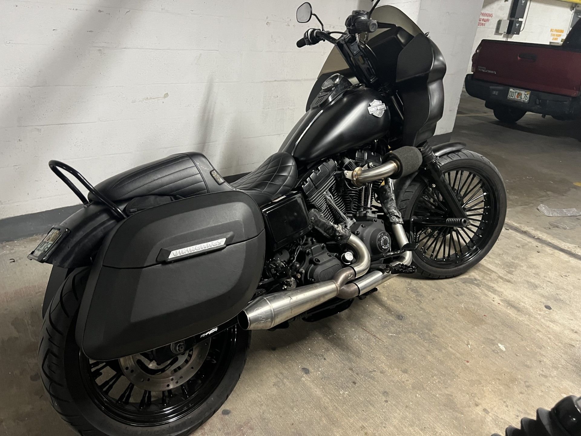

Old Sep 26, 2023 | 08:52 AM
Raul De Armas III's Avatar
Raul De Armas III
2nd Gear
Joined: Apr 2021
Posts: 6
From: Miami Beach
Default You won't be disapointed
21 inch by 3.5 and a larger tire works supreeme and has a better lean angle. Put a fork brace on and there is no comparison to the 19 inch stock set up. What an improvement in handling and stability
Old Sep 27, 2023 | 03:04 PM
GREENOHAWK69's Avatar
GREENOHAWK69
Joined: Oct 2006
Posts: 3,660
Likes: 713
From: DFW
Great looking bike.
