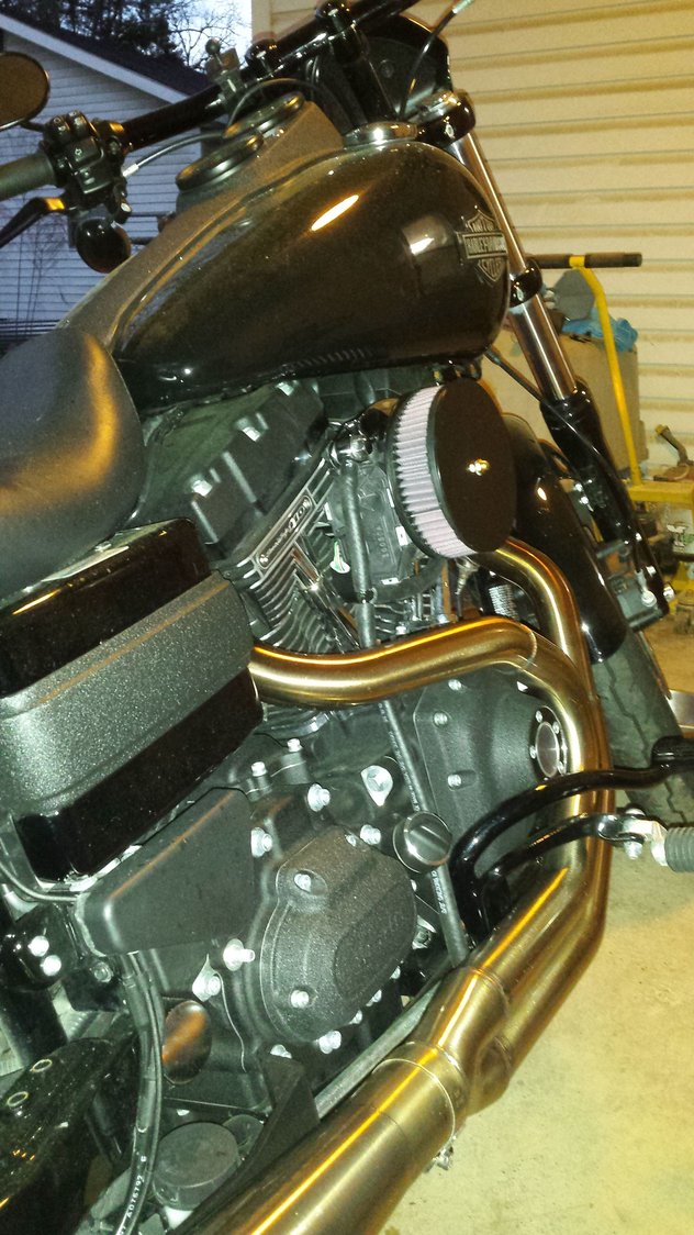

I used a kit from dk custom products when I went to a new air cleaner from them. They make some to modify the stock cleaners and aftermarket non vented ones. I just routed mine down behind the mid controls to a filter. Not the best picture or cleanest install but serves it's purpose and good enough for me.
