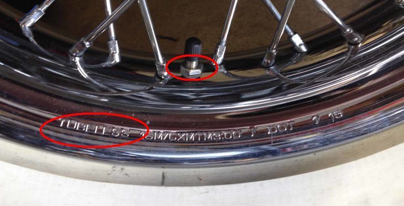

I've got mixed information about whether or not they are tubeless. I do know some smoothies are but also some dealers put tubes in them because they are a pain to get to seal correctly. Also mine do not have tubeless stamped in them anywhere like some have said it should if they are in fact tubeless.
Correct...16" example below

Actually a very easy way of telling if you have tubes or not. Tube valve stem will have a nut on it where tubeless valve stem will not. I can't see either valve stem in your photo to be abal to tell.
