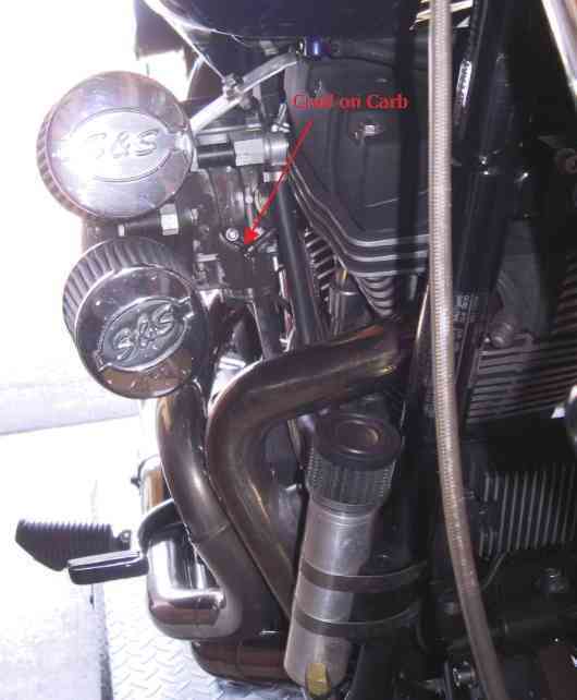

The first 2 work well on a 113 evo and 131 TC ci motor. Notice the last one bled oil mist all over the carb and dust found the oil.. Last is a 116 TC..
113 ci EVO
131 ci twincam
116 ci twincam

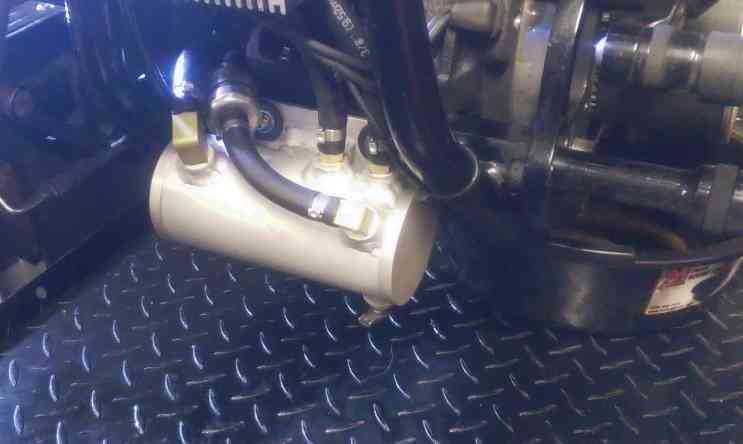

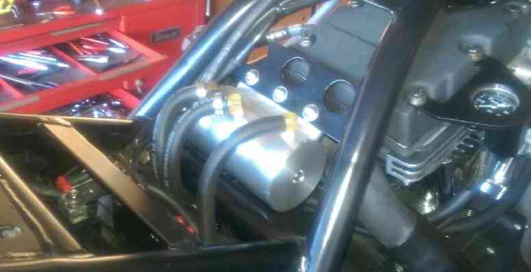

Default Made a little mod
I posted earlier that I had tried the Golan mini catch can but didn't use it due to my experience of getting a little oil around the vent holes.
I just modded another ac (yes, another - got a heavy breather extreme/elite/whatever it is) and decided since I had my new FuelMoto e series pipe I didn't want even a little dripping on the brand new heat shield, so I dug out the Golan and made a little mod.
I figured since the inlet was basically right next to the vent holes, that was why it was leaking some (note, it's a really small amount. I'm just nuts, so this probably isn't worth reading for most normal people).
So I picked up some 1/4" ss tube and made a little dip tube that puts the blowby on the bottom of the can, not the top. It fit right in the inlet barb, pinched it slightly to give it a little resistance, coated in jb weld and pressed it in flush. Also cut the included foam in half and put a hole in the middle just for the hell of it.
Installed it this morning and will run it to work this morning. We'll see.
Here they are. Had one PC'd for the LRS and the other is for the RG.
Installed (yes, gotta get that T PC'd black...)
