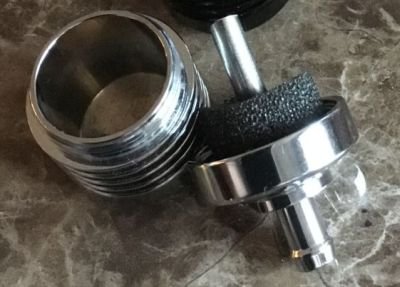

I don't know how close your tube is to the bottom of the can, but you might keep an eye on oil accumulation. When/if it the tube end ever gets covered...might
restrict venting (I guess it should push through with pressure).
May be no big deal... Of course you can adjust (shorten) the tube as needed.

So I picked up some 1/4" ss tube and made a little dip tube that puts the blowby on the bottom of the can, not the top. It fit right in the inlet barb, pinched it slightly to give it a little resistance, coated in jb weld and pressed it in flush. Also cut the included foam in half and put a hole in the middle just for the hell of it...

Thanks for the pics, now I know whats in those little buggers. Should be interesting to see how well it looks after a few thousand miles.. Not sure the added tube will help. If oil covers it. on starting, the tube will clear in the bottom of the bowl depending on where the crank stopped from the last run..
Good point, but I was figuring on the positive pressure taking care of it. Also, you can't see it in the photo, but I cut the end of the tube at an angle so it'll never be flush against the bottom, and it also only goes about 3/4 of the way to the bottom of the can. Should be ok.
Just to note, after my 30 min ride to work (it's only 9 min, but I take the *very* long way to make sure it gets the oil hot enough)I once again had a little stuff along the vent holes. I cursed as I "felt it up" when I "got off" the bike before I realized it was only water, from the bit of vapor boiling out of my oil. So no worries there.
