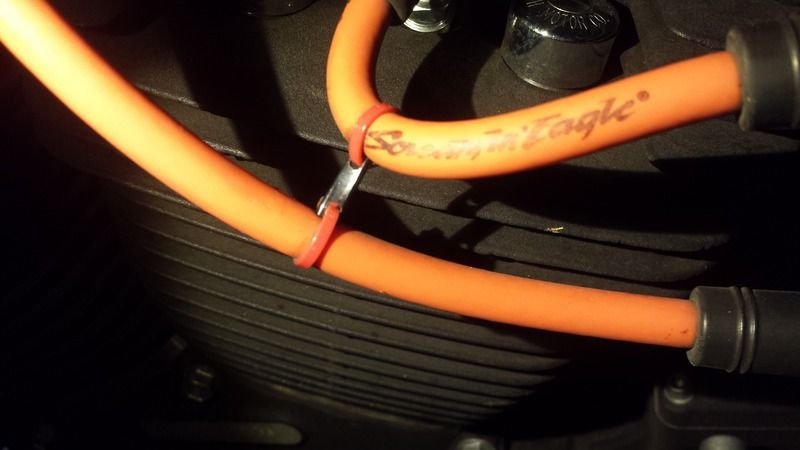

I replaced the oem plug wire holder above the horn with a generic insulated cable/wire clamp available at most hardware stores:
Old Mar 11, 2017 | 07:21 PM
junkyardscrounger's Avatar
junkyardscrounger
Posts: 344
Likes: 36
From: Dayton Ohio
It looks like a trip to the hardware store for one of those insulated clamps.
