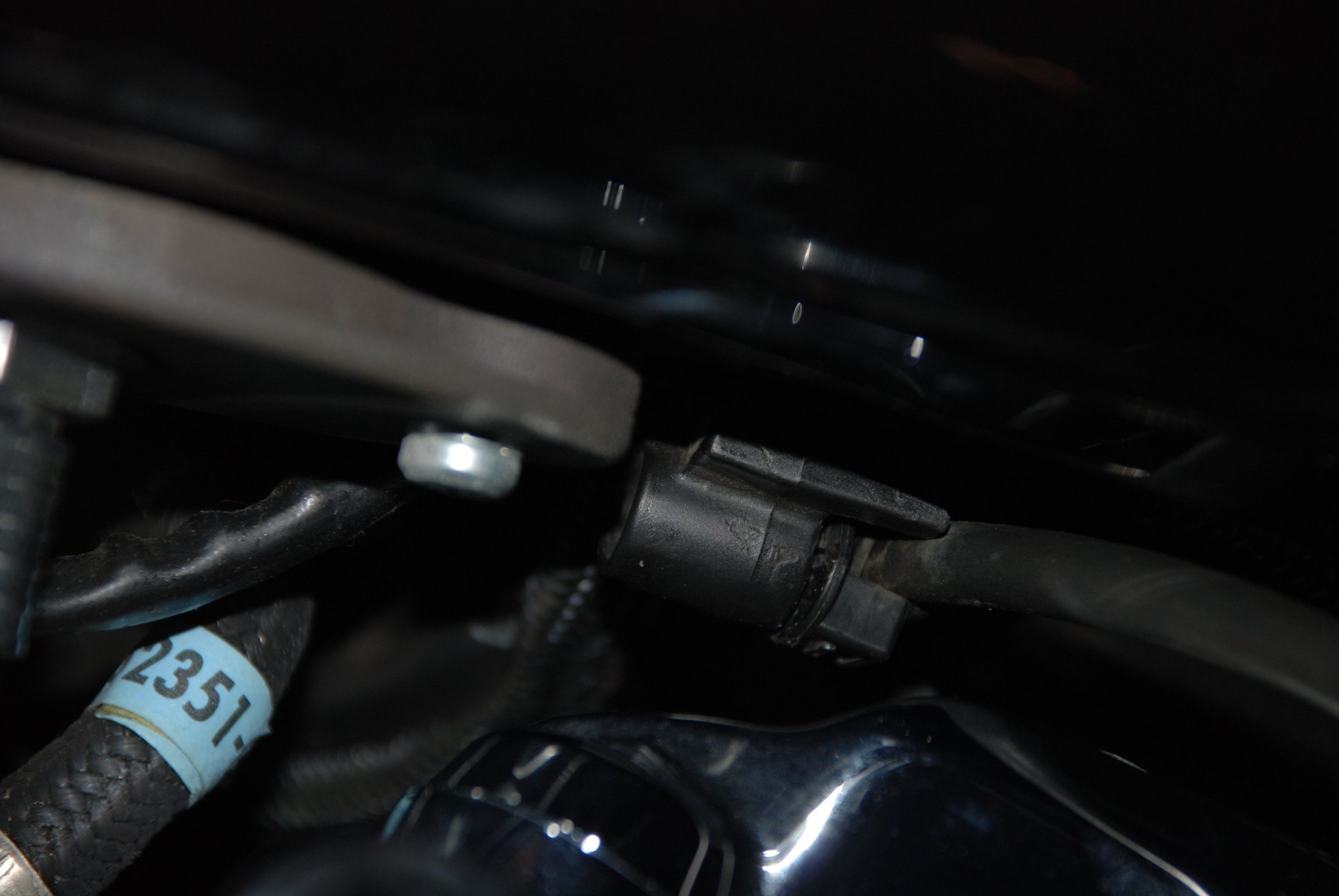

the plug wire is coming into the picture on the lower 3rd of the picture and the harness is right about the cylinder head.
Here is as good as a picture of it that I can take.....the plug wire comes from the right of the picture and you have a view of the little plastic harness...but not the wrap that goes around wire..... it seems to me you are saying once I cut the wrap the pieces will fall away from the harness...is that correct?

Yes, mostly.
This is how it happens.
1. Cut the part that wraps around the plug wire. It is the same width and thickness as a standard zip tie.
2. Pull the plug wire away from the clamp.
3. Fiddle with the cut zip tie to push it out of the hole in the clamp. You may have to cut the zip tie a bit more to get it out of the clamp. Mine just fell out after I cut the zip tie (I just did it yesterday, but my plug wire isn't routed there anymore so I'm not reusing this connection. )
Trust me, once you cut the zip tie and remove the plug wire, you'll see how it's put together.

thanks a lot,......I know what you mean now.....after I cut the existing tie, all I will have to do it put a new zip tie through pull it down tight and cut the long end off....is that about the way it goes?

Yes, but the cleanest method is to get one of the push-pin type zip ties like the picture I posted above. Your dealer has them.
