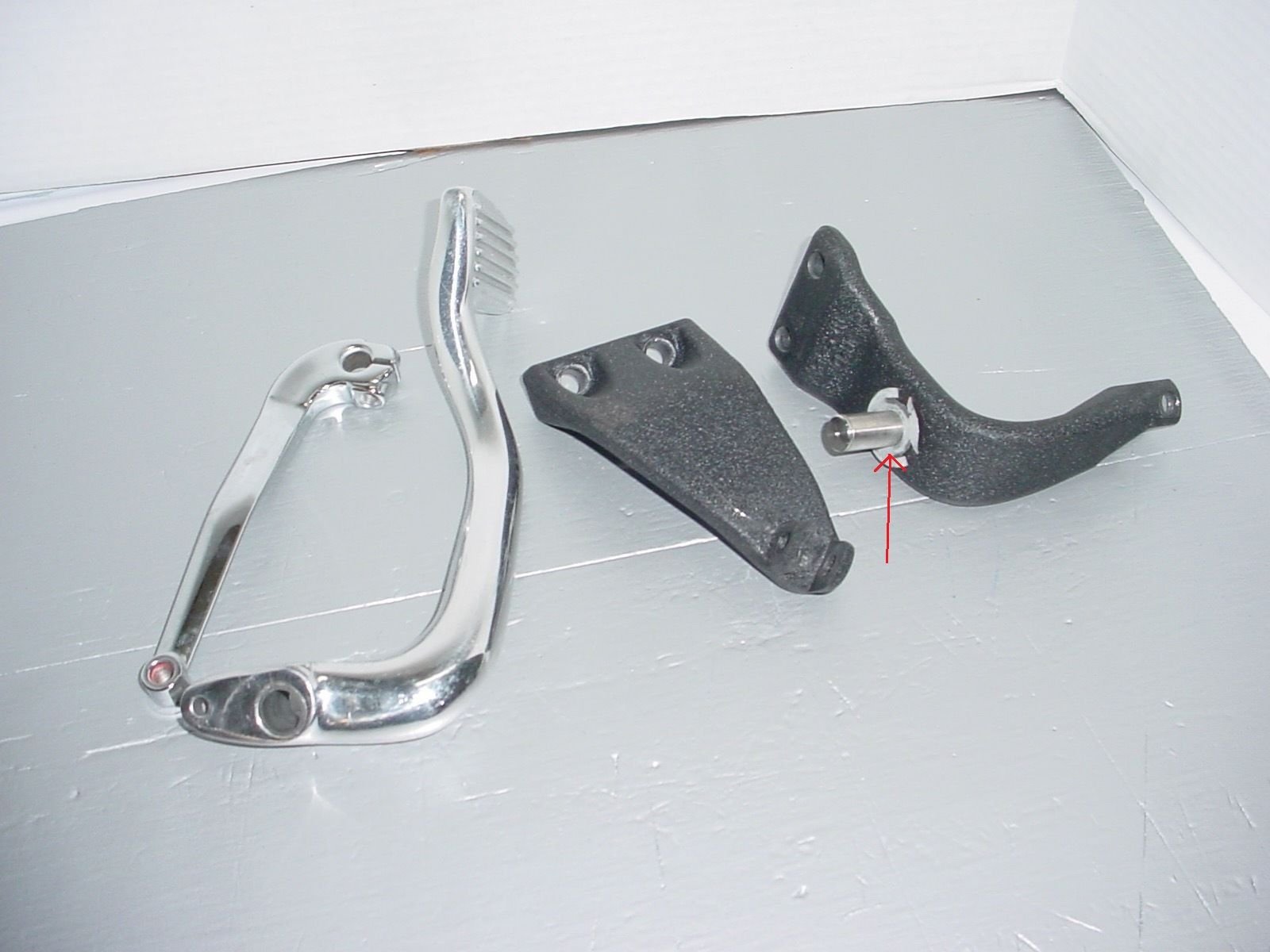

Taking my mid controls apart to be powdercoated and came across an oddball part which I have been unable to identify online. The current one is old and I'd like to replace it if I can find one. Anyone know the name or part number o what the arrow is pointing to?

That is HD part #7003 - Finger Spring Washer
Make sure you get it back in there where it's supposed to be or your pedal may cause the rear brake to remain engaged.

Good find GVan. It didn't show that washer on the "footrests" (mounts) page, but of course it does on the "Rear Brake Control"

I would believe it to be part number 7003. http://partsfinder.onlinemicrofiche....=26&c=0&d=2013 FXDB DYNAŽ 96 STREET BOB (GX4) BRAKE - REAR BRAKE CYLINDER W/ PEDAL

Try New Castle HD if you cannot get it at your local dealership.
https://shop.newcastlehd.com/catalog...idson?sku=7003

Thanks fellas. I looked at the Ronnies site before I posted this, but the shape shown in the display threw me off.
Appreciate the feedback!
