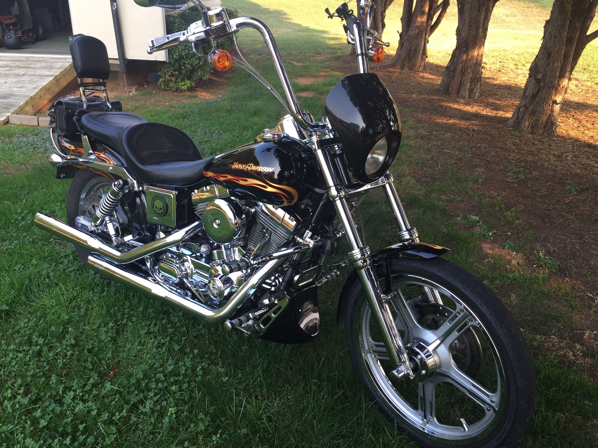

04 with turn relocated on forks whiskers paint set and head light 2 into 1 exaust<br/>
