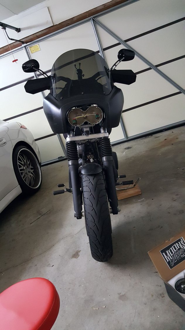

Tried the Triumph ones; must have been too old...they split at the bottom in short order. Then ordered a pair on ebay; they had few pleats and looked like plastic.Got a pair from Jammer Cycle, I believe, on ebay and they went on yesterday...here's the look. Chrome clamps on top are until weatherstrip adhesive sets up, they were just a bit bigger than 49mm and were a good stretch over the seals on the bottom (I removed the chrome dust covers). Heat gun helps, I think. We'll see how they last
