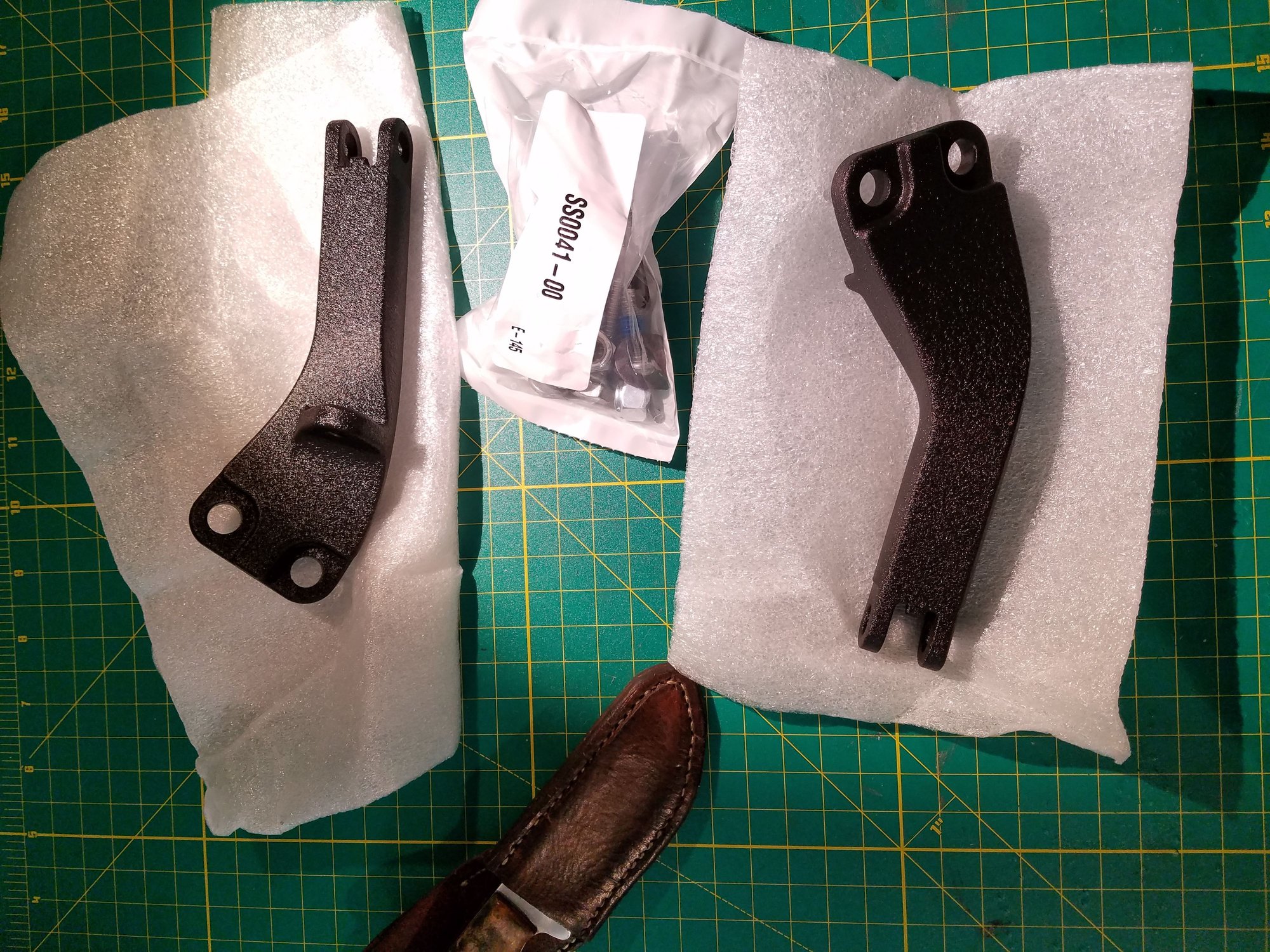

If anyone knows where to find small 3 pin deutsche connectors, like the ones used for the factory switches let me know. Im trying to make everything as clean as possible. Also, the plastic sheathing/ tubing Harley uses to shroud the wires , does anyone know where to order some? having trouble finding this stuff.
Today I picked up some parts.
Got lucky on these passenger peg mounts. I got the last set before they went to back order.

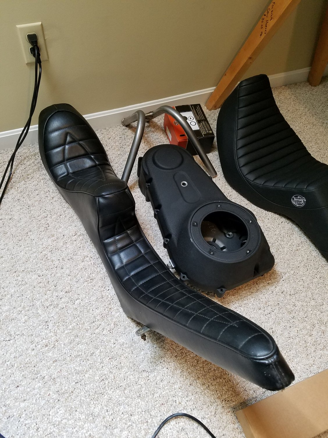

Picked up some FXDWG fork tubes. They are 2" over standard FXDB fork tubes. Since my rear shocks are going to be way more money than I originally thought , I decided to ditch my original front end paln. Eventually I will pick up the Ohlins NIX22 inserts for these tubes and still have a wicked setup. Going 2 up in the front and 2 up in the back.
Thought you guys would get a kick out of this seat I'll be running on a future shovel.
Honestly I can't wait to get this project done so I can start another old school chop build.

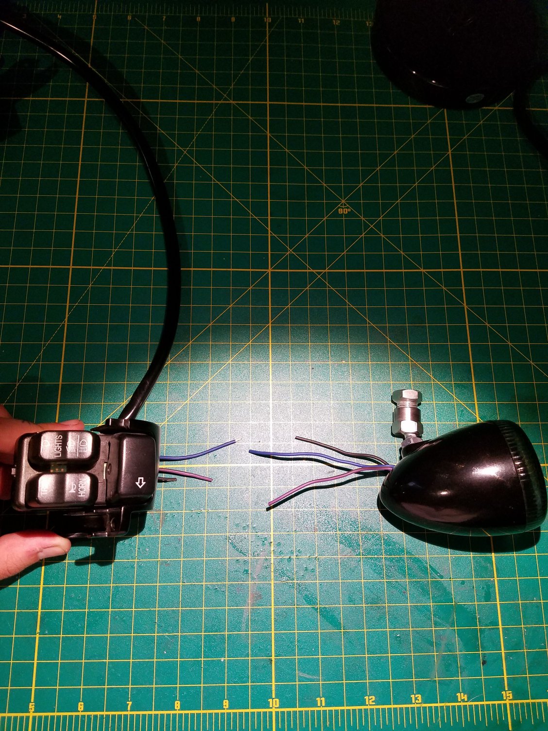

so I extended my turn signal wiring today by about 4 feet. I'm running the turn signal wire through the the switch wiring harness , which goes through the bars. After they dump into the frame right behind the neck , I'll run the turn signal wires into the fairing where the lights will be behind the mesh vent found on fxrt front fairing. Should make a clean look and hopefully still be visible.
I love doing electrical stuff on bikes. So this was a nice way to spend a saturday.
Pretty sure harley spec is an 1/8th of an inch when it comes to stripping wire. I did a little over , but it doesn't really matter, as long as the solder job is good.
nice and clean. All the cuts were staggered so no bulge will be noticeable in the harness. It'll be in the bars anyways.
I need to find 3 pin 20awg deutsch connectors and the sleeving used to cover the wires and I'll be set to wire the bars for good.
