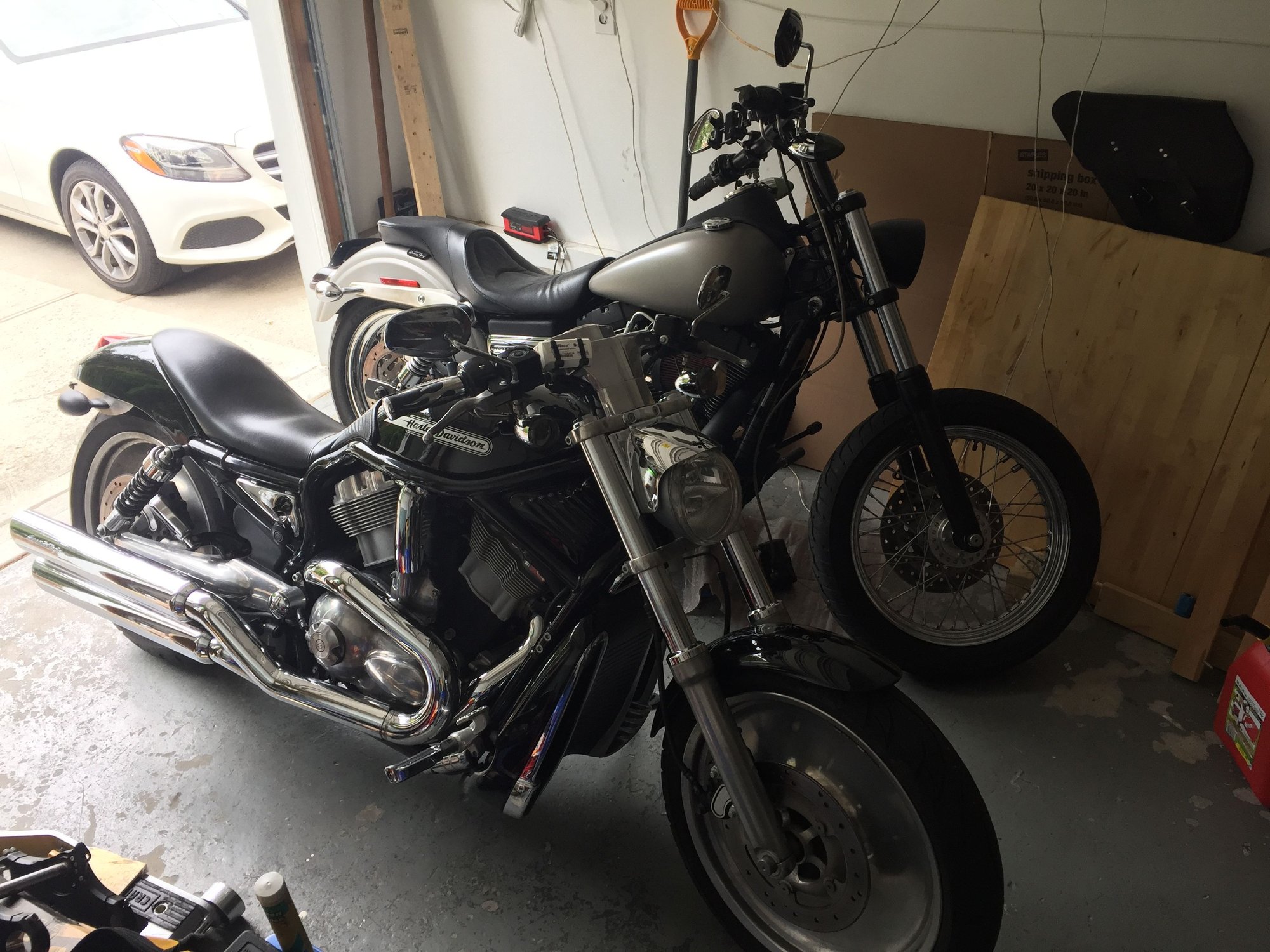

So I got frustrated and just going to bring my bob to the local Indy and let him put the front wheel and caliper on. Really had the itch to ride so this happened...
