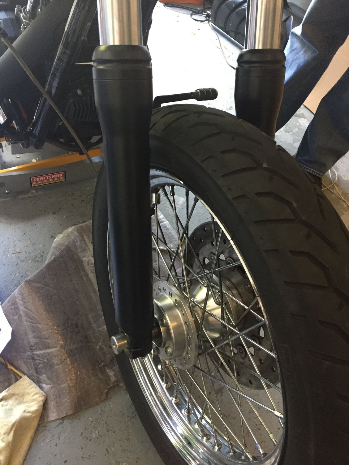

Long story short I tried to change the front end from a wide glide to a mid glide and failed and now own a vrod in addition to my bob lol.. a beer sounds great right about now.

Is there still a spacer on the brake rotor from when it was set up with wide glide trees? If so, that will stop the caliper from lining up

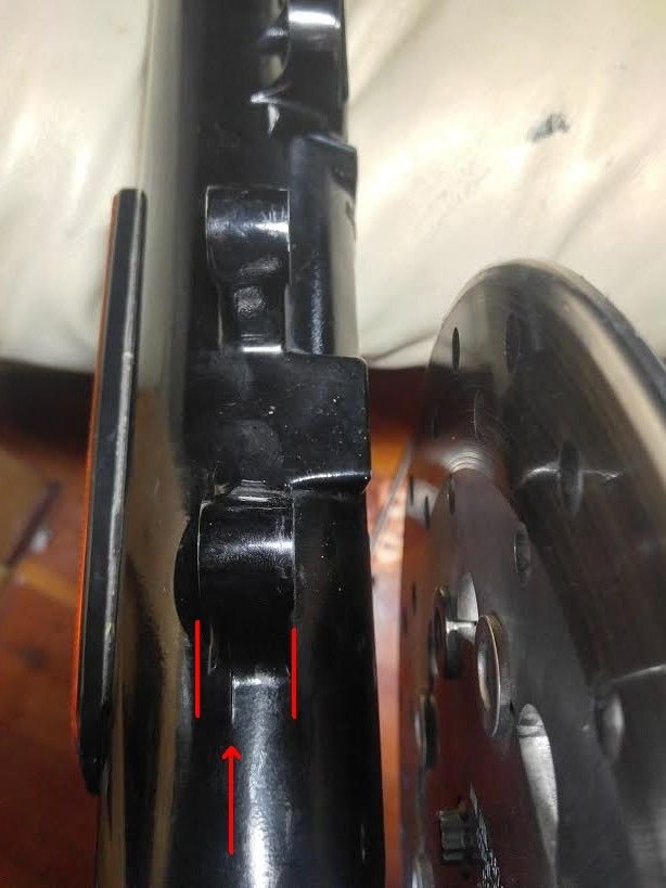

Are the caliper mounting bosses and the casting line "Off-Center" (like shown below) or Centered?

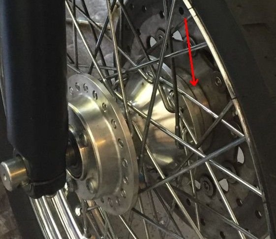

Looks like you still have the rotor spacer installed like Tat2u mentions...You have to remove that
Wow... feel a little stupid lol. Is it hard to remove?

So yeah bikes back together. Thanks for all the help everyone.
