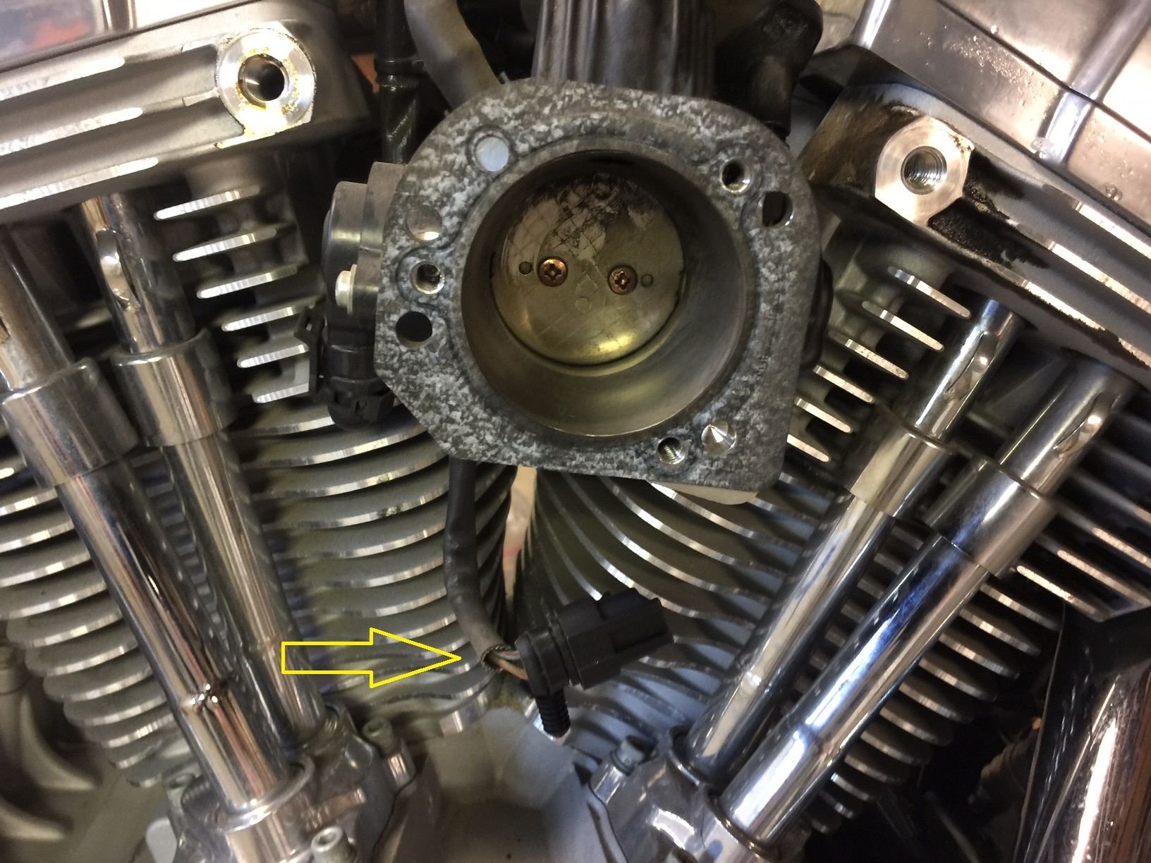

I'm finishing up my handlebar swap project on my 2006 FDXI. I was buttoning up the air cleaning assembly and noticed this plug. Is this something that I missed? It appears to be just hanging behind the air cleaner assembly. I don't remember seeing this when I was tearing into everything getting access to the throttle cables. Any help would be greatly appreciated. thanks

Have a look at this video, about 2 mins 30 into the video you will see what it is, you just need to tuck it back away behind, video is in French but you will see what I mean.

active exhaust plug. it would have been clipped on to the back of the stock a/c backplate. not used state side. just ziptie it somewhere.
