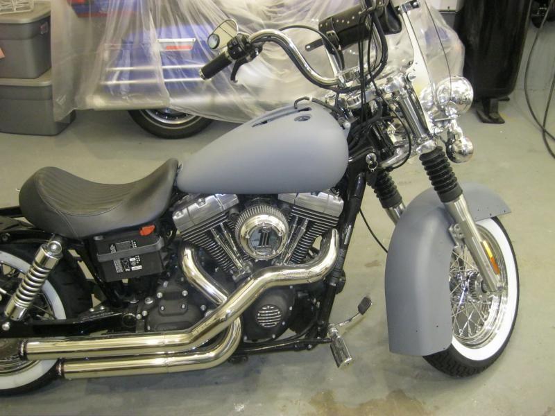

There is only a few things you really need:
-Fat Bob trees
-FLH or FXDF axle for 25mm bearings
-FLH or FXDF 16" front wheel
You can reuse your wheel spacers (they will fit).
Your brakes will line right up reusing all your Street Bob components.
Now for the front fender, A FXDF fender will fit but the mounting holes will have to be re-drilled as they will not quite align with the mounting points. If you want an FLH style fender, there are adapters out there.
I have done this on a Street Bob and a Sportster (before H-D was doing it.)
I eventually switched the Street Bob over to a Softail front end for the complete effect

Wow, your bikes look great. I have got the fat bob trees now so just hunting down/getting made the wheel spindle. I'm going more for the bobber look so will have a minimalist front fender, thats what so great about Harleys, each one is individual.
