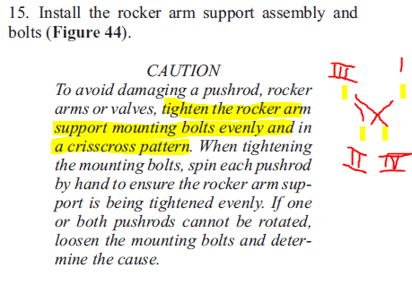

I went on you tube and found the specs for the rocker arms and the other 6 bolts, but it said to do it in a certain sequence which I don't have.
crosswise
