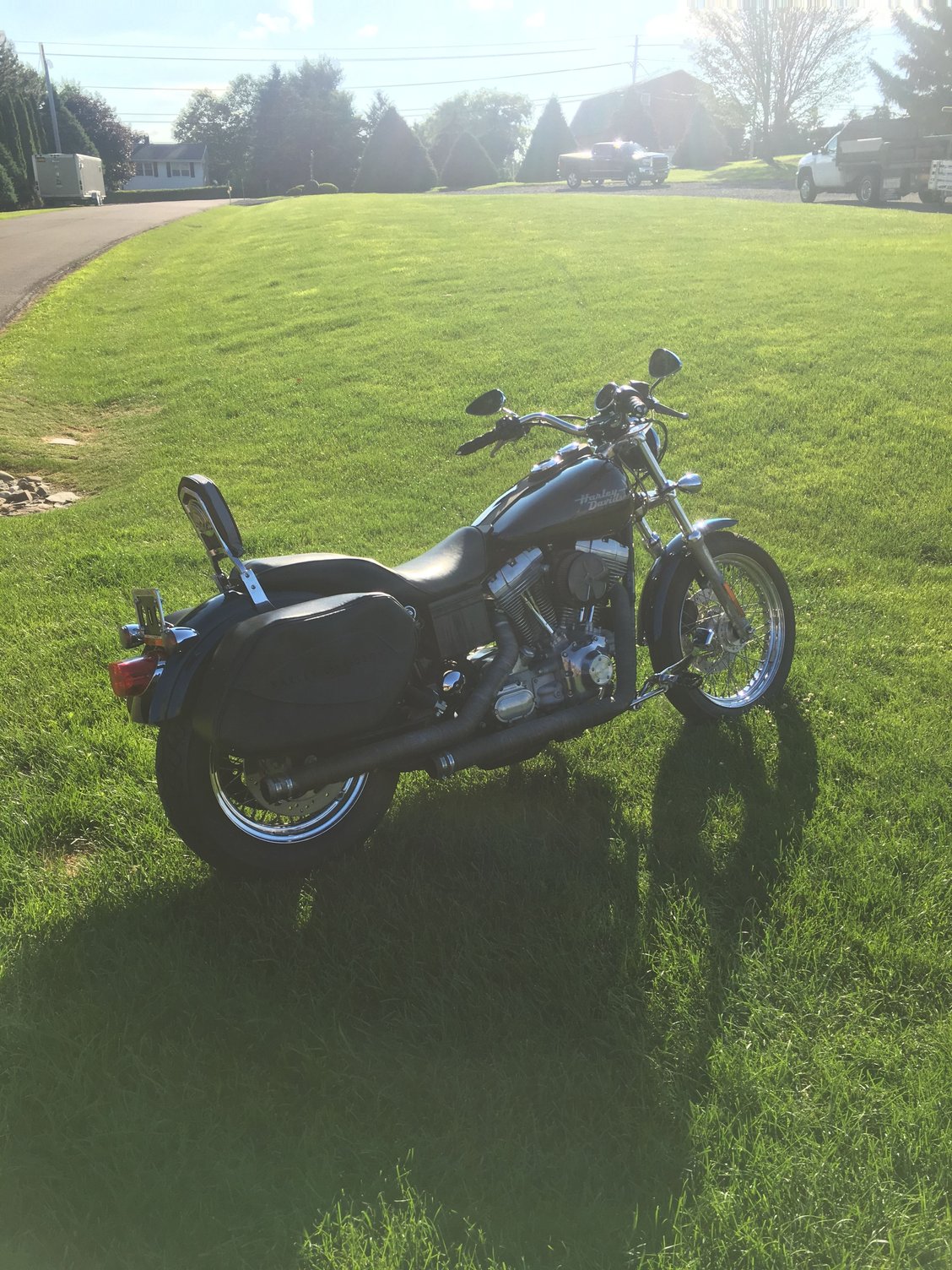

hello everyone, I recently picked up my first Harley, an 02 dyna superglide. I'm new to Harley's, sold my jap bike for my dyna. Very happy with it so far. I'm looking into changing it p a little bit since it's completely stock other than intake and exhaust. I was wondering how high of bars I can fit without cable extensions. I wanna go for T bars, people say I can fit 8-10" on stock cables. I'm on a budget so lengthening the cables is out of the question for now. Also what are some other good first mods to do, and things to watch out for. Thanks everyone

My opinion?
Lose the bags and sissy bar and find a used solo seat. Add gasoline and ride.
