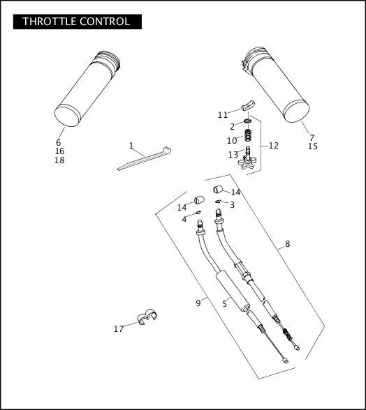

They are now replaced. Anyone know the part numbers of the plastic clips holding the cables in place to the frame?

Is this the one you need it is number 9 in the image.
CLIP, cable to frame Part no. 40645-06

That seems to be the clutch cable, but maybe it will work?
What about number 1 in this picture?
"CABLE STRAP, throttle cables (3)"
Part no. 10073
http://www.ebay.co.uk/itm/Harley-Dav...IAAOxyOMdS6l7l
