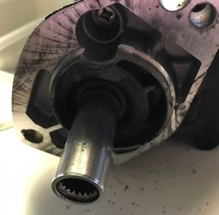

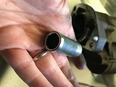

Had to replace my starter this weekend.. Got everything back together, tried to fire her up.. and nothing.. just the whirring of the starter not catching the clutch gear.. Note: this is NOT a guitar slide!
I didn't even think of re-using the jackshaft coupling! Details.. Lol! I had researched all day long reasons why it wouldn't catch, being a new starter and all. So I asked my husband "if the coupling was put on backwards, could that be the reason for it not catching?" I grabbed it off the old starter to show him what I was talking about.. he looked at it, and then at me and said almost laughing.. "Where did that come from?? I've never seen that until now.. That explains everything!!" I was so embarrassed.. Luckily he's patient understanding! When we installed the starter, we were "nascaring" it Sunday morning, trying to beat the heat. He was on the primary side, I was on the starter side, so he didn't see I missed it.. He said he thought it didn't feel right, but this was the first time installing a starter on a Harley, so... After pulling the starter off, installing the coupling, putting everything back together, & replacing the old battery the next day (not enough juice for it to turn over) she was up and running!! It was a very frustrating and sad weekend (not being able to ride). Laughing about it now... all part of the learning process! I guarantee that won't happen again!
