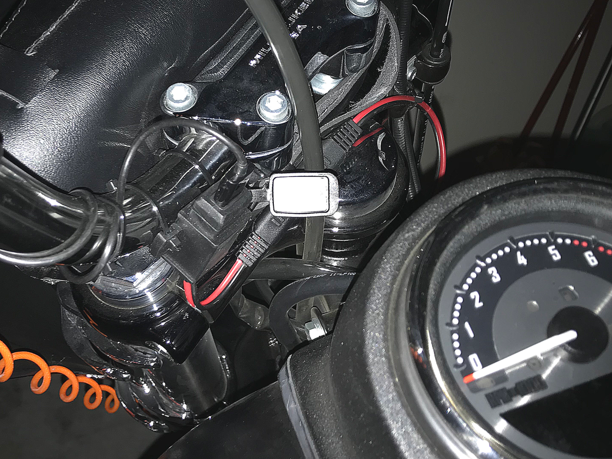

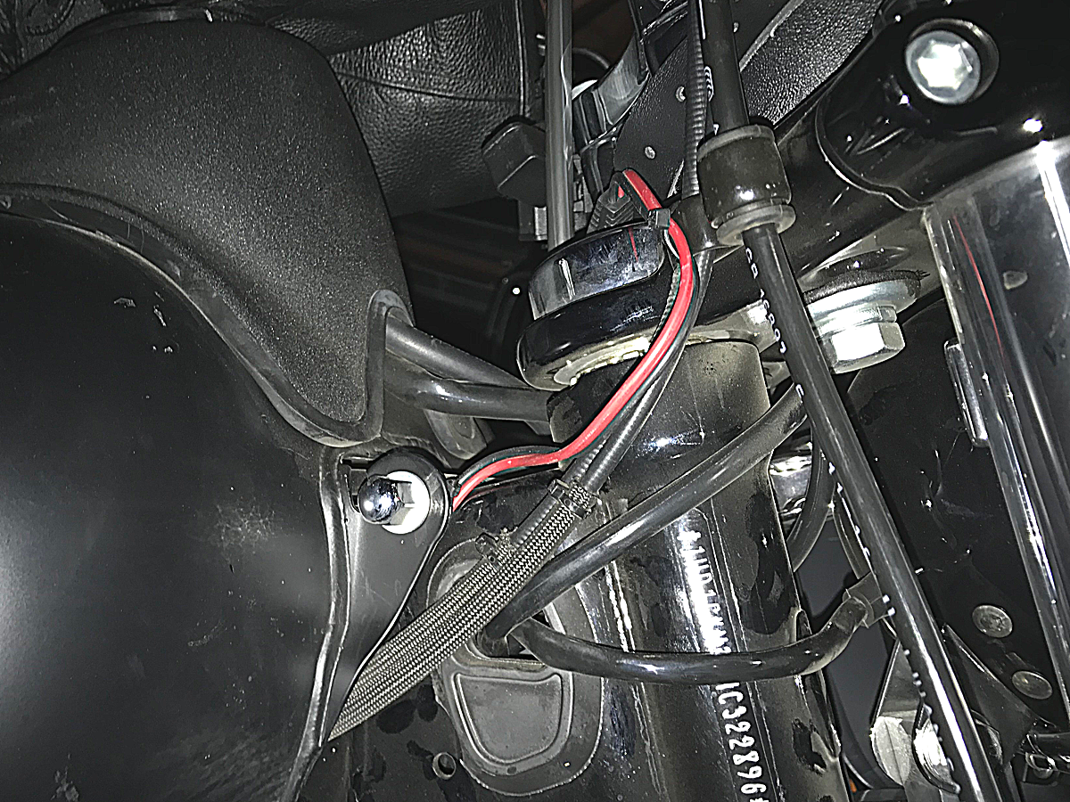

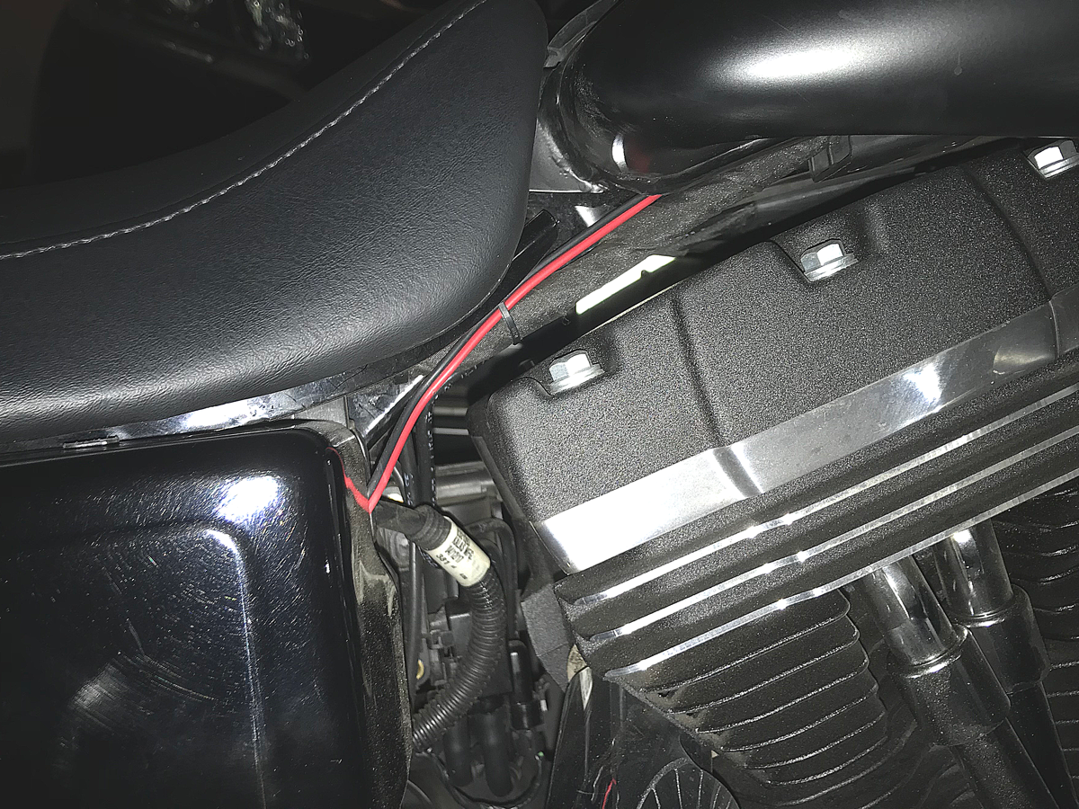

Battery to tank:
Exit from front of tank:
Handlebar:
