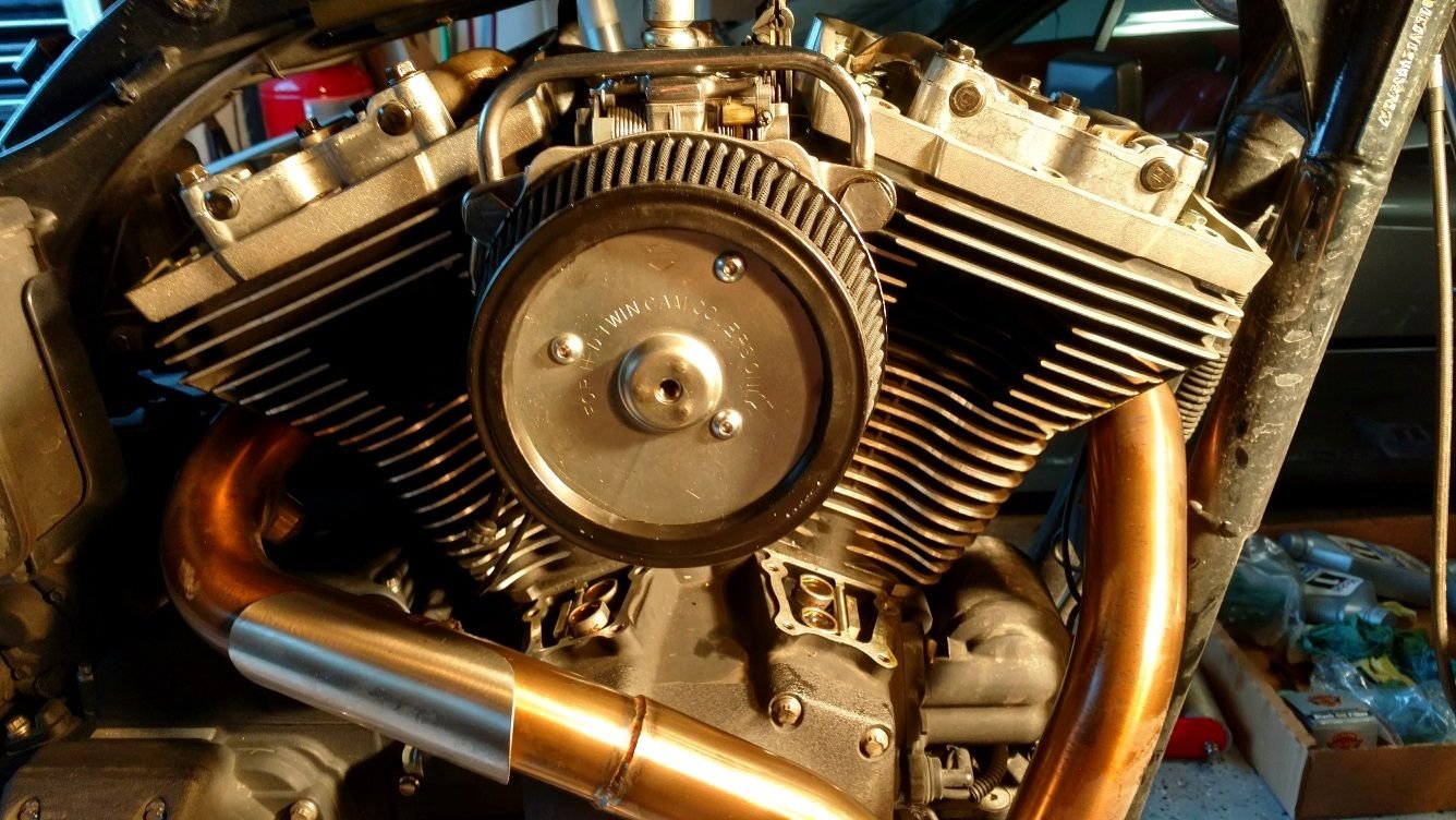

I started with the rear cylinder. Took out the exhaust pushrod, rotated the engine. It made the sound. Took out the intake rod. It made the sound. Moved to the front cylinder. Exhaust rod out. Made the sound. Intake rod out... The sound is gone! All of the lifters appear to move correctly, and seem to be properly filled with oil (visually).
Figures the problem was in the last one... I should have started from the front!
I think I'll try putting that one rod in without the tube, taking lots of care while adjusting, and see what happens...
Forgive my uncharacteristically filthy bike... The last time I rode I got stuck in heavy rain, and cleaning it hasn't yet been top of mind!

Adjuster nut(s) hitting the tubes?

Well, I installed just the front intake pushrod, made certain I was at TDC on the base circle, set it at .135" of preload, and turned the motor. The sound is back, nice and loud. It was a little difficult by myself, but I tried to pinpoint it with a stethoscope while turning the rear wheel. Definitely not up top. It's the loudest right at the front of the cam cover, as far as I can tell.
I guess the pipe and cover are coming off now...

I thought of that... That's why I just tested without the tubes in place (we were typing at the same time).

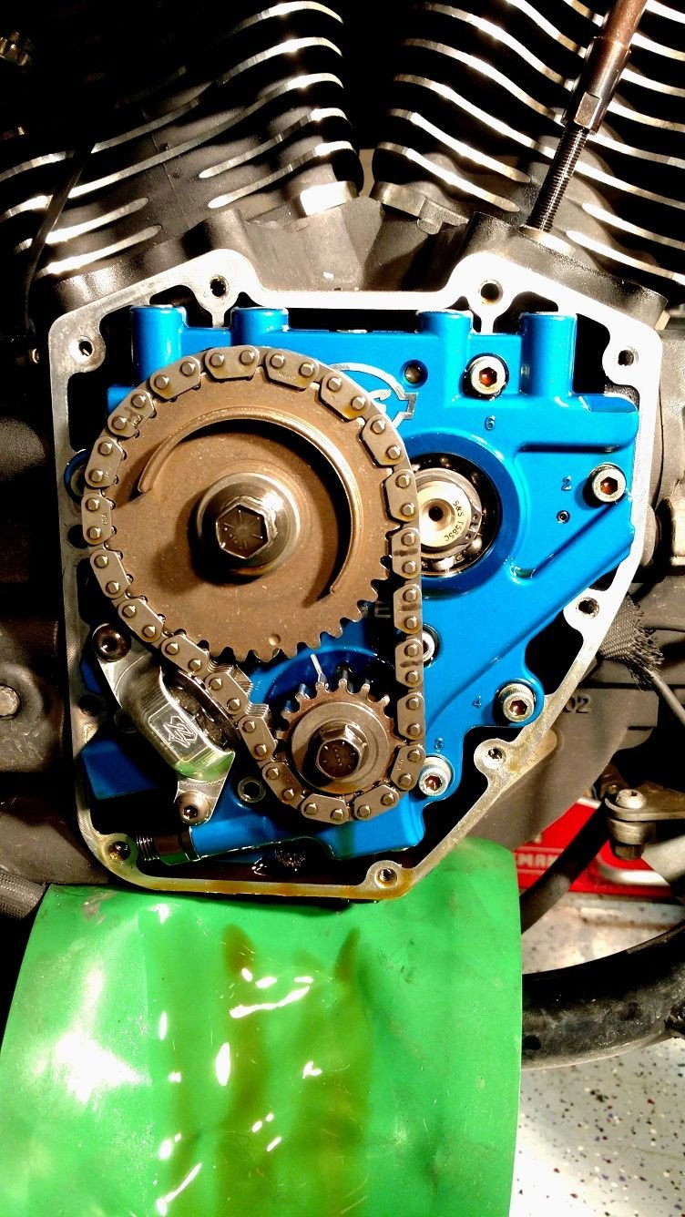

The only good thing about opening the cam chest again is seeing all of this good stuff...

I'm getting closer... I think I've found the source of the sound, but not the cause. It seems to be this guy making the noise, one of the Zipper's Red Shift twin piston hydraulic tensioners:
