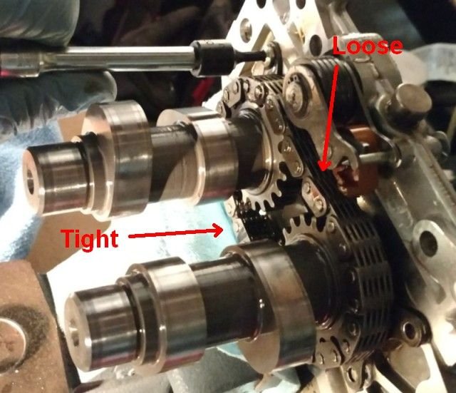

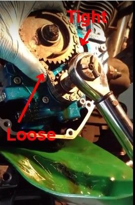

That last video was very informative...
In this particular case, I think you're seeing ("hearing") the result of no/low tension on the secondary chain. How much pressure do those hydraulic tensioners provide with NO oil pressure like in this case.
Before the front cam lobe reaches the summit , you (with your wrench) are driving the valvetrain and there is tension on the lower portion of the rear chain. After the front cam lobe crests the summit, there's a point where the valve spring pressure becomes the the driving force (in this no/very low speed scenario) and "snaps" the cam ahead and now there is tension on the top portion of the rear chain. I think you're hearing that snapping transition.
Put your finger on that rear chain while this all happening
(I used the same rear view pic of your old Cams/plate and just changed the wording.)
You're Driving it Here
Then the Transition

I've been kinda thinking the same thing...I wouldn't be concerned about the loose/tight chain thing.
You removed one pushrod at a time until you only had one left. What happens if you remove that one and install one on the rear cylinder?

Anything on the Rear Cam shouldn't have that transition that would change the Secondary (Rear) chain tension.
But I would expect that changing to the exhaust only on the front cam may cause the same original issue.

Hey Multi - Thanks for taking the time to illustrate your point so well! I appreciate it a ton! And yes, I understand what you're saying... It makes sense that the position of chain slack would change depending on the nature of tension at any given time... But it shouldn't make that noise... I also get what you're saying about the tensioners not having pressure right now, but I can hear the noise when it's running. There is a very noticeable metallic tapping coming from the cam chest that must be the same sound... That's what caused me to start poking around...
