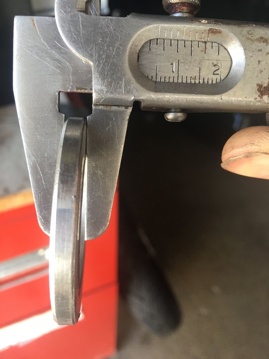

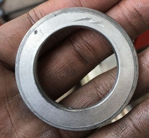

Btw, what's the thickness dimension of this shim?
will check tomorrow need to find my caliper lol

It's a 41455-08C kit, but if you want to use other bearings such as those Timken 205pp bearings then buy the 41748-08 spacer sleeve (same one as you measured earlier) and 41450-08 shim separately.
That shim in the photo "appears" to be wider than a 41450-08, that's why I'm asking for a measurement.
But wouldn't a smaller shim make the axle spacer more loose inside? Is that what I need? Also the timken bearings are a different width than oem bearings?
The numbers I quoted are what you need... Buy them separately.
No, those 205pp are the same dimensions as the OEM (9276,9276A,9276B). Which is a Bearing industry Std# 6205-2rs.
Even using tape measure on that shim now might be enough for me to know if it's wrong

Shim is 5 mm multihdr

Shim is 5 mm
Yeah, that's the wrong shim. The correct shim is approx .068" (1.73mm).
So maybe what happened is that with the wider shim on the Primary side, the Secondary Right-side bearing ran out of bore depth before it could "tightened up" on the sleeve which caused bearing preload when the axle was torqued...effectively like having too short a spacer sleeve
