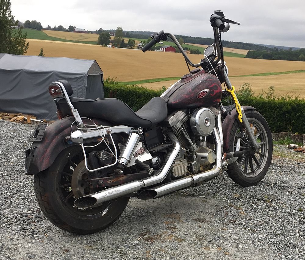

Day one...

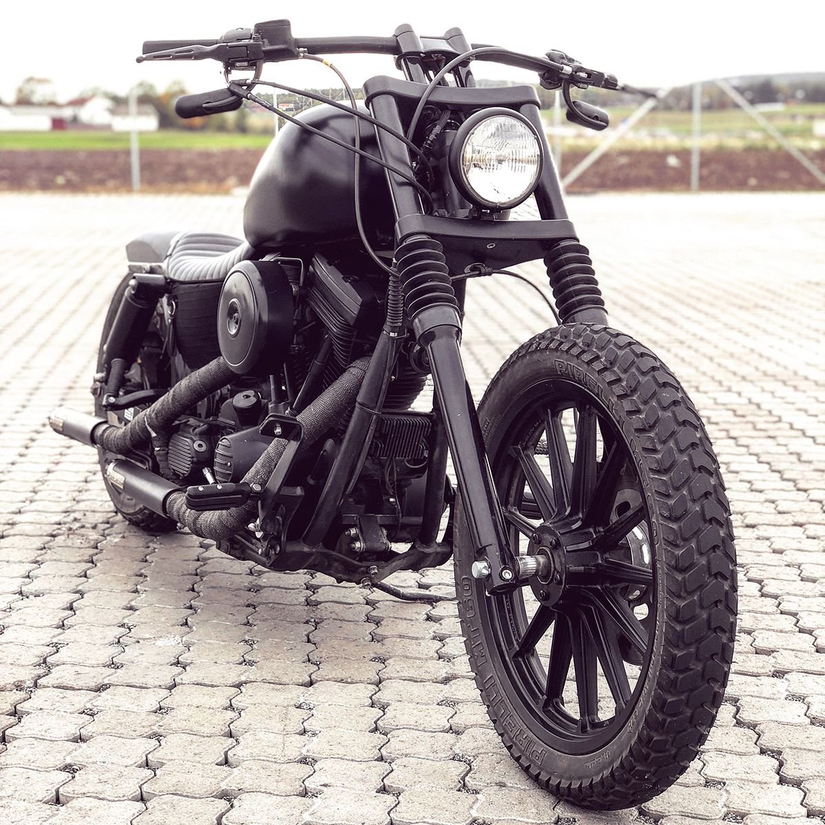

Finished build... So far. Will re-paint during the winter. Also thinking of swapping the tank to a Sporty tank and fit a 150 tire on a 16" rim in front.

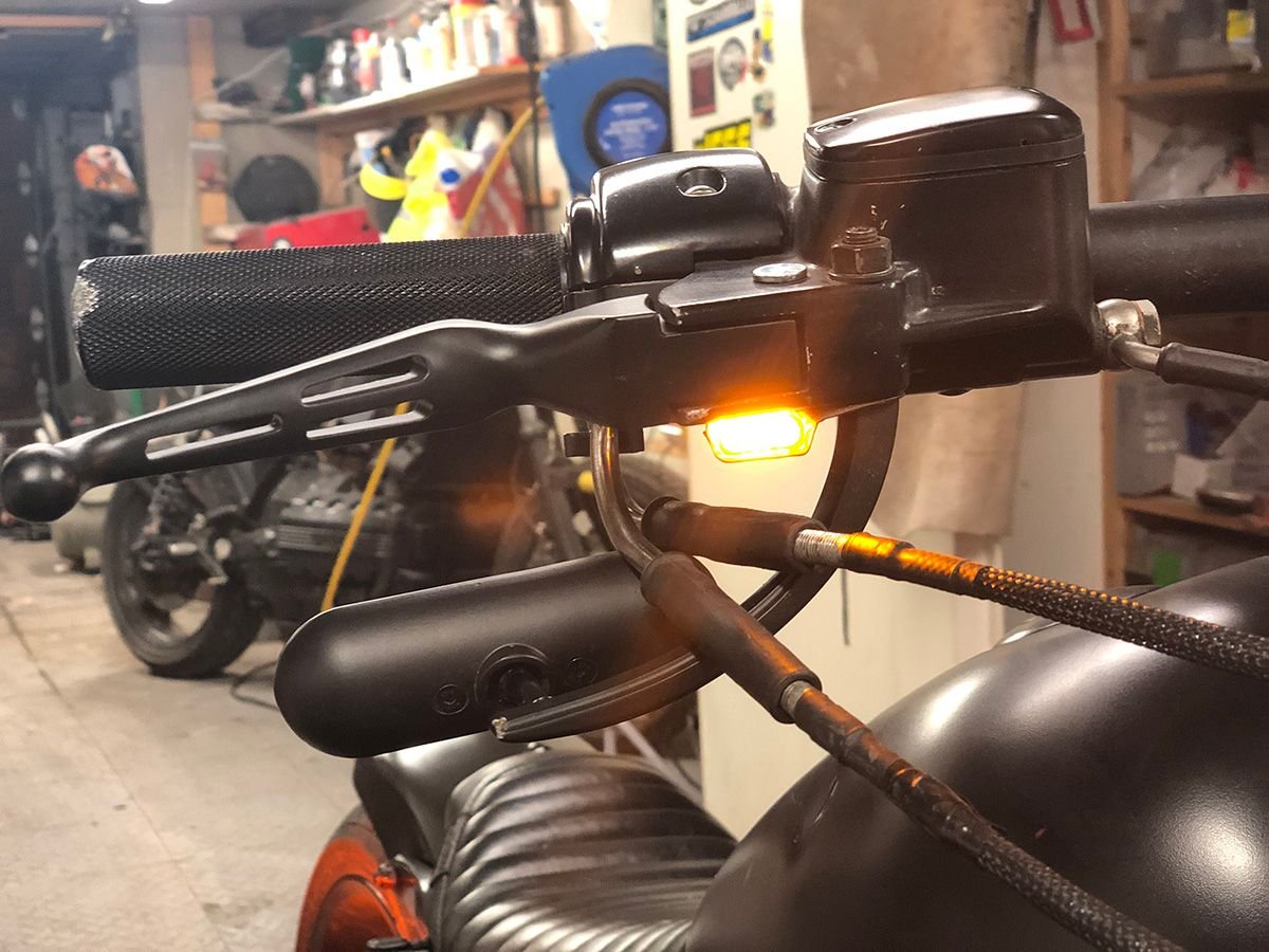

Tail light / indicators and speedo:

Great bikes, all of them but your dyna is killer. What lights are those for the turn signal?

So what did you end up doing in the front? ... has a good stance
Thanks. Tiny LED's. Not sure if they're available in the states though.
Rear: https://www.dock66.de/taillight-sign...black-slimline
Front: https://www.dock66.de/Micro-Indicato...oke-215-x-8-mm
Thanks. 5 degree cups and 3 degree wide glide triple trees for 39mm tubes from Hawg Halters. Stock tubes with extra spacers to stiffen it up the springs, and 30wt oil. Works great.
