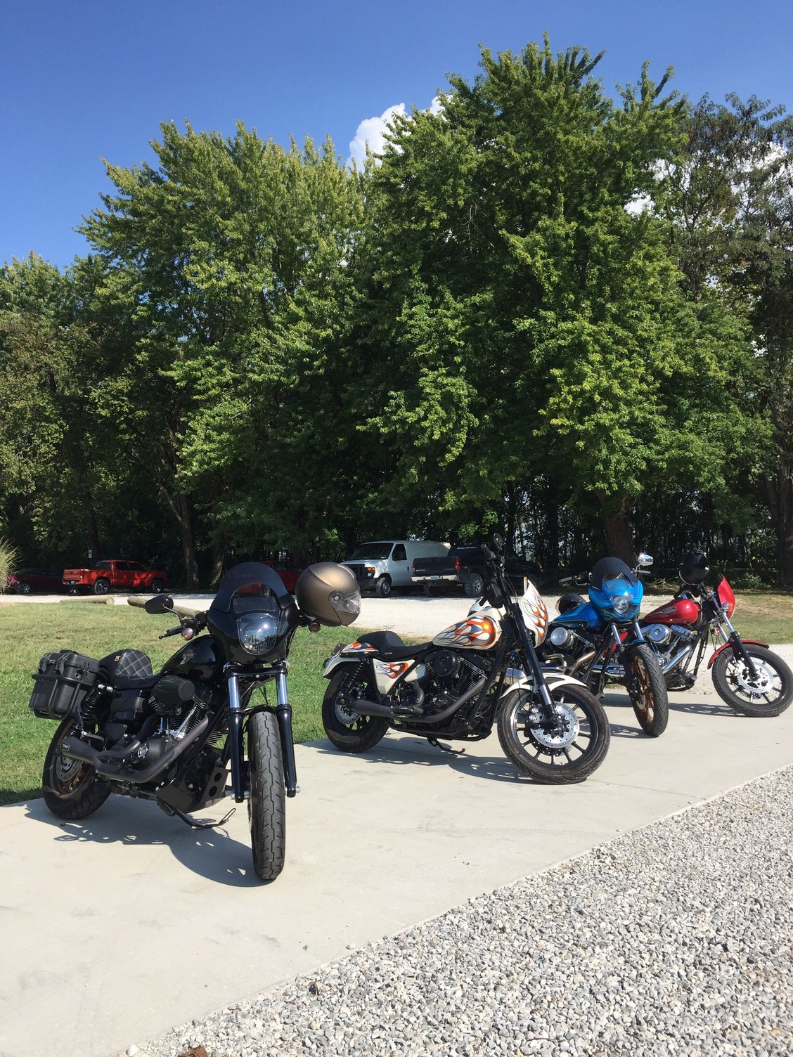

I'm planning on starting a TC powered FXR build next year sometime. The FXRP models are popular. The 1994 model year is also highly desired. There are lots of options out there to dial these bikes in to where they really rip on the twisties.
This is a pic from this past weekend. My LRS, then a buddies white 1994 FXR built by San Diego Customs with paint by Hot Dog Kustoms. The blue bike is my brothers 1988 FXRP with paint by Scott Takes at Underground Art Studio. The red bike is a 1994 that belongs to a friends father. All three of them have 111" S&S motors. They are cool bikes and are noticeably lighter and smaller than the Dyna. The frame geometry really works well and they are easy to flick through the corners. As far as the motor mount issue, Alloy Art currently offers good solutions.

Thanks for the info guys. There's a dealer somewhat near me that has a 94 low rider in stock that I'm going to go check out and sit on. I wasn't aware that the frame was dimensionally smaller then the Dyna's, which may be an issue for my 6'2" oversized ***... But that's easily determined in person. Probably wont get a dealer bike, as they'll likely want to bend you over on the price, but its worth taking a look. Not a lot of options up north...

You might be surprised. My brother is 6'6" and his FXR has the police floorboards on it, and he loves the way it fits him.
