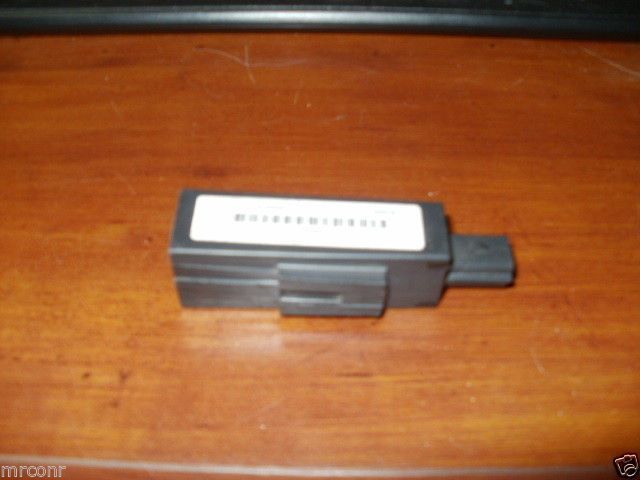

double check your antenna under the seat. extremely unlikely that it came off but, have a look.
looks like:
