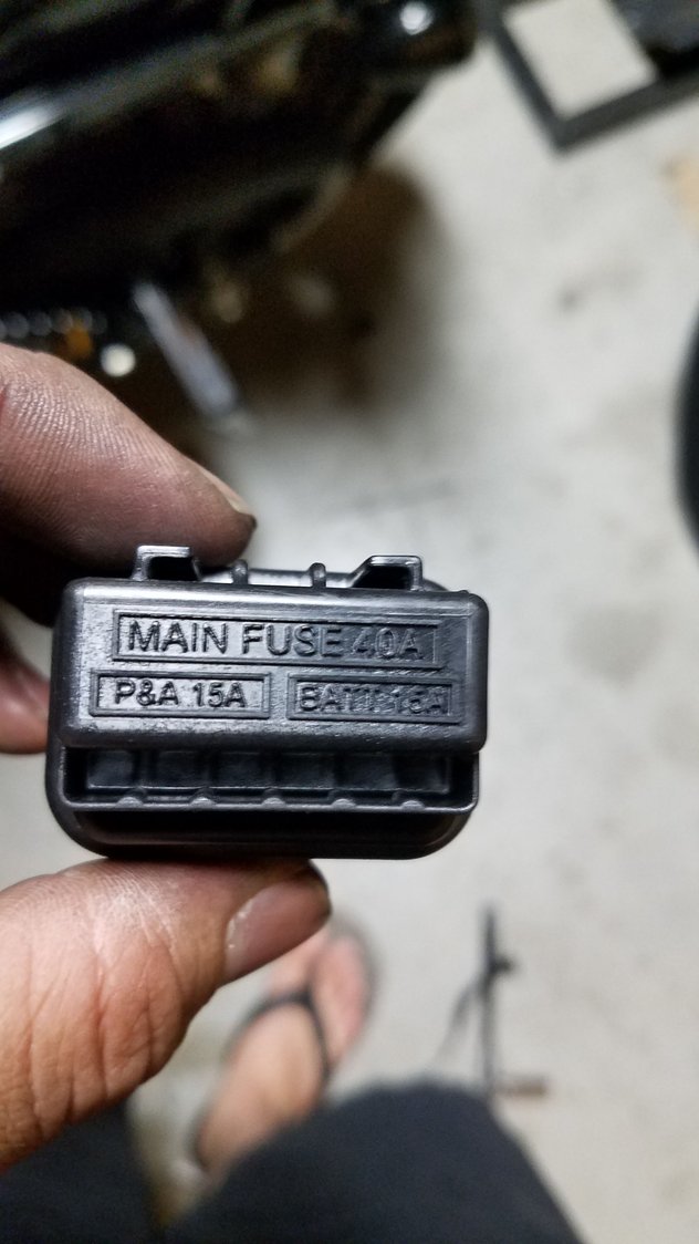

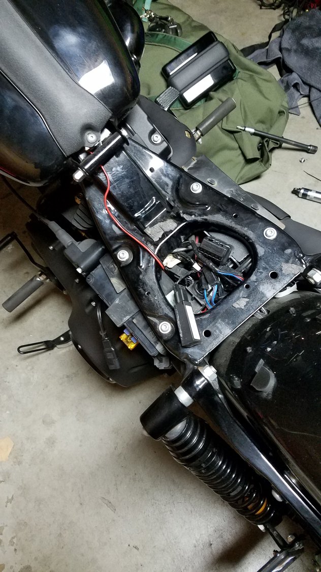

Hey everyone. Hoping to get some feedback diagnosing my issue. I currently ride a 2017 low rider s with 5k miles and unfortunately came across a no start issue today. It all started from simply swapping out my risers. I swapped them out and starting my bike, my check engine light came on bright and strong. Some trouble shooting later, it turned out to be a ripped tbw wire. After re-soldering and reinstalling everything, she failed to start up. So now I have to run through everything again. Everything below is what I checked for..
-turns over strong
-fuel pump sounds like its priming normally
-wires that I touched were all connected
-all 3 fuses were good
​​​​​​Once I got to the spark plugs, they came out completely dry, so I am assuming my issue is something with fuel. Anyone have any idea what this could possibly be? Bike was running fine earlier today, so I'm pretty stumped about this. I currently don't have a manual to work with, so any help would be appreciated!
