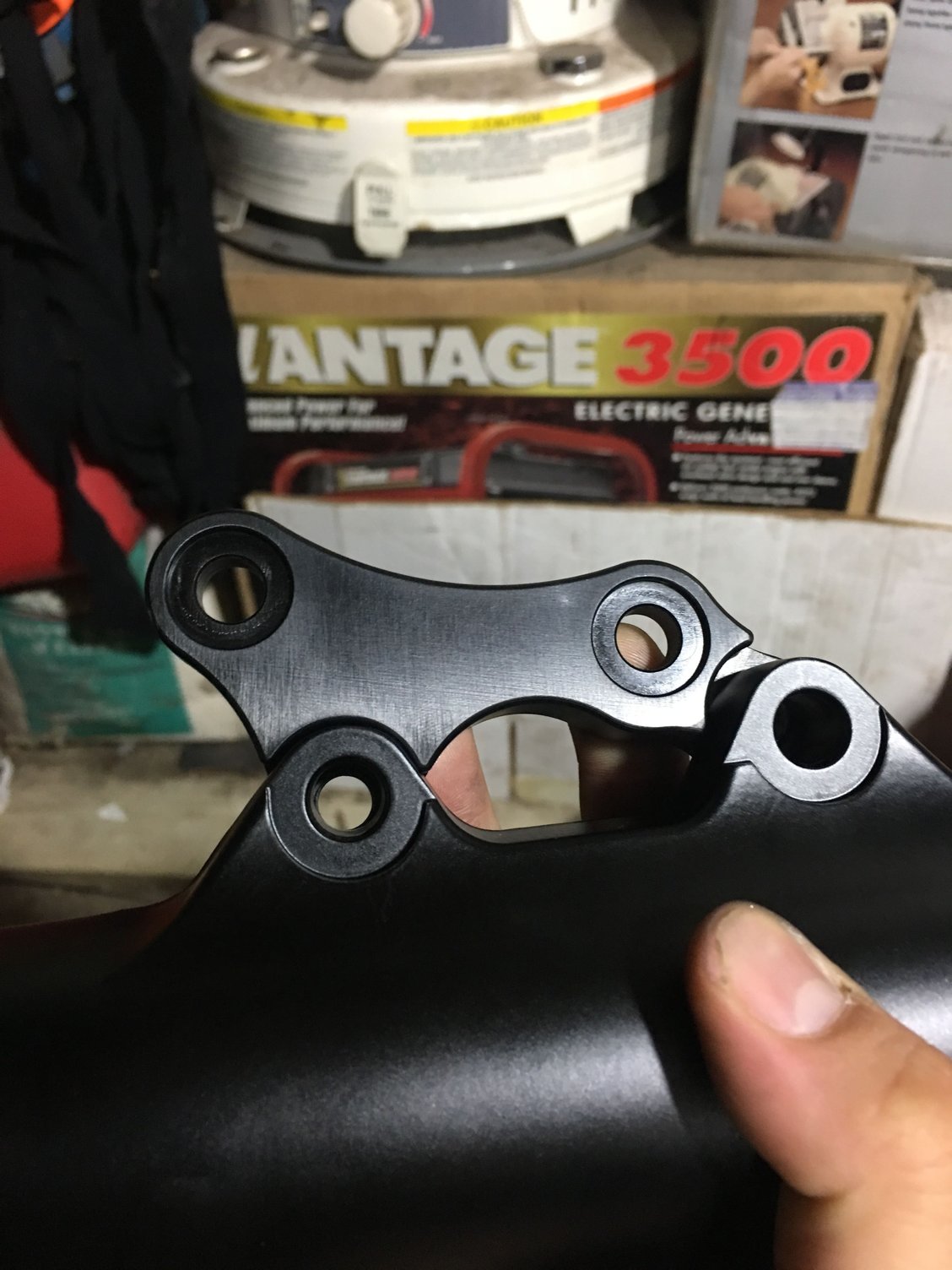

I'm in the process of piecing together a dual disc conversion for a 2009fxd using a 14 fxdl rh slider and have a few questions regarding caliper options

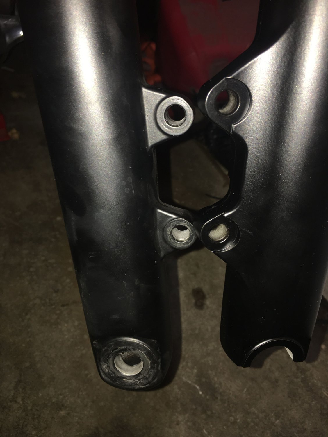

does anybody else other than qtmi make brackets for 65mm twin pin brembos? 06 -up dynas?(already talked to Howard as well) I ordered a set and while the left side fit the rh slider is slightly different and doesn't line up Lowrider rh slider appears to be made slightly different than my stock 09 lh slider as there's more metal on the tabs
Comparison of both sliders
the only reason I tried going with this setup is because a member here that goes by the name of buellrider did this same swap and apparently had no issues (08 dyna, used fxdl rh lower as well ) unfortunately that guy has not been on here in a year checking on his profile.

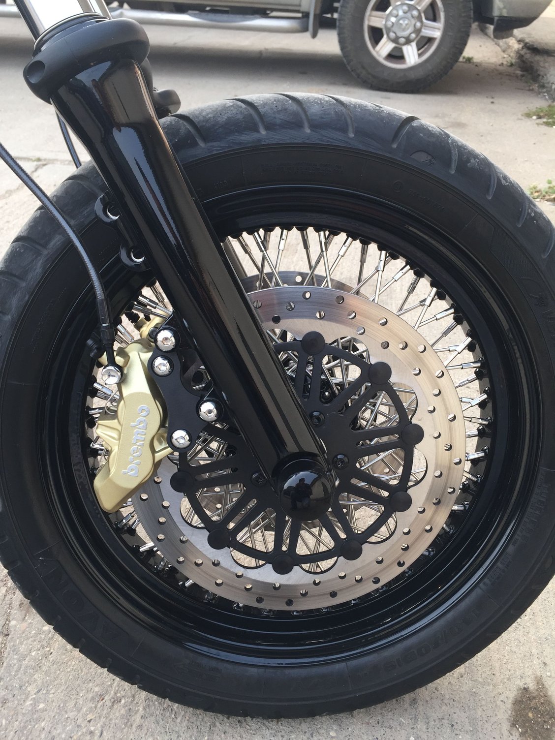

Who did you order from? Got mine for my FXDF through QTMI (Tara) and it bolted right up.

Damn that looks good.

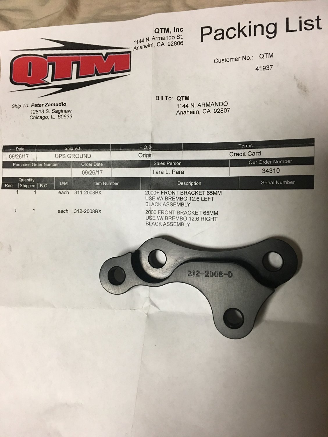

yup I ordered from Tara she said she has no idea why the bracket won't fit it has to be the slight design change in the fxdl right hand slider(14). The left side bolted right in but that's my original slider that came with the bike(2009)

Found it but can’t post from my phone right now but here’s the left side bracket pn
210-2102BX

Yes, the sliders are different castings, but the holes are in the same locations. It appears you just have a bracket to "New/Later casting" interference and some relief is needed.
FWIW, buellrider76 is using 40mm Brembos so those are different brackets and don't really compare.
If you don't feel comfortable massaging the parts, you might see if you can send to QTMI. They might do it as a courtesy to see how their parts fit the newer slider castings.

These are the part numbers for the brackets and the rh bracket itself
Apparently they haven't made a bracket for the later castings maybe like you said multi maybe I can offer to send the slider along with the bracket for them to design a newer bracket for later models and help everyone out in the end. I'll call Tara Monday to discuss
