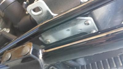

Sorry for the bad picture. It's attached under the cam chest. I was thinking a support plate for stock exhaust maybe?

yup....stock exhaust bracket☺

Stock exhaust bracket

the stock front exhaust mount is all sorts of a pain in the *** to get off...ended up stripping the t-27 torx due to the positioning of the frame, so i just grabbed my dremel and just ground the heads off, dropped the plate, and then used channel locks to remove the stud's.
picture of stupid mount below,
guess i should have invested in one of these...
https://www.amazon.com/Lang-Tools-Exhaust-Bracket-Wrench/dp/B007TX0DEO https://www.amazon.com/Lang-Tools-Exhaust-Bracket-Wrench/dp/B007TX0DEO
i wish i would have known that beforehand oh well, life sucks get a helmet!
Yeah it is!
I just left it on when i swapped exhaust 3yrs ago and to date nobody has ever asked what it is or why it's there.
