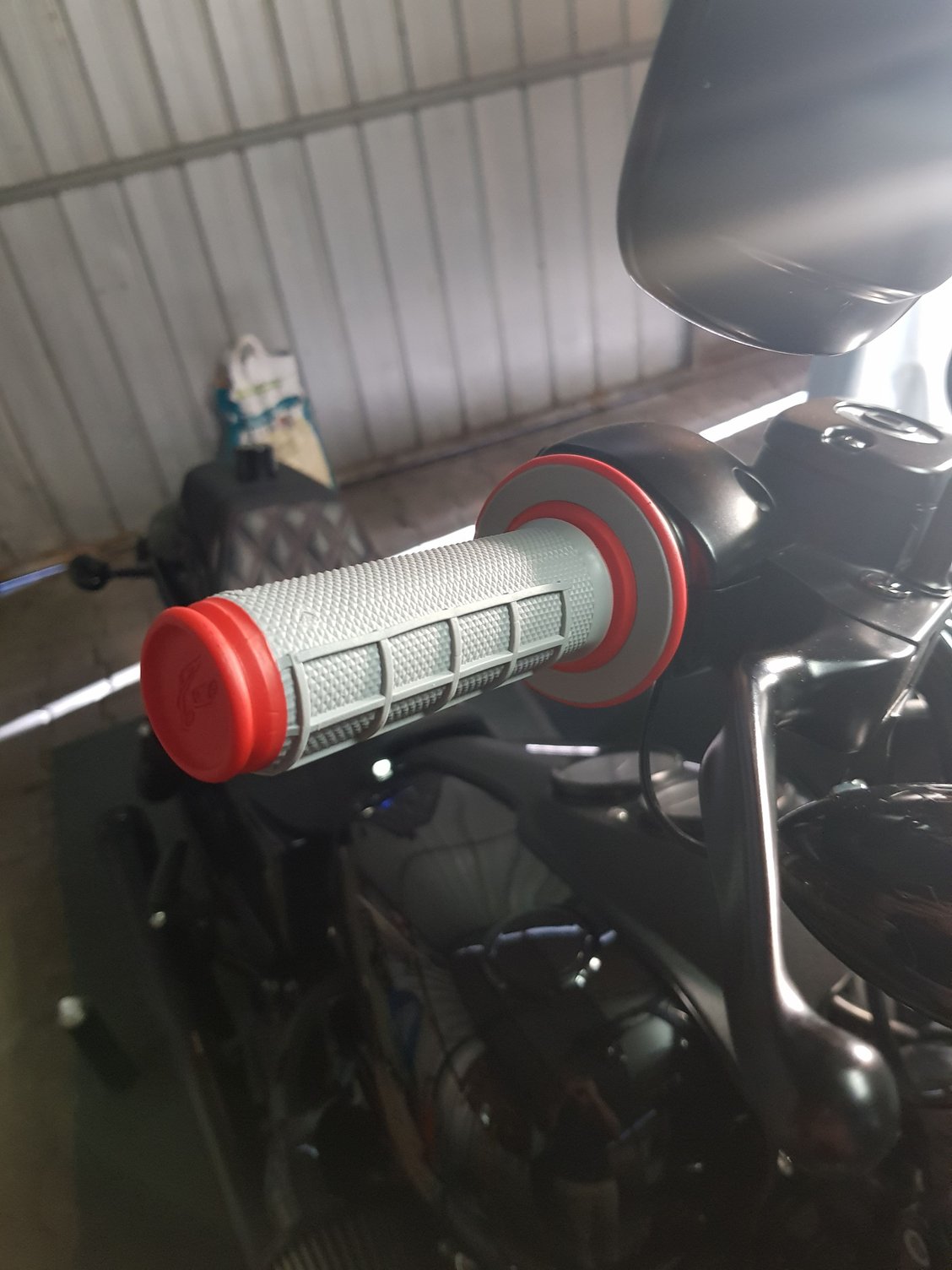

I think he cut the stock rubber grips off the stock sleeve and pushed the grips on that, I'm gonna give it a go tonight and posts some pics.

Gents, all I had to do was cut the old rubber grips off of the stock tube and slide the new Renthals on.
Had them in hot water for about 5 minutes, got a **** tonne of hair spray (Cheers shibbby911) in there and they slid straight on, checked this morning and she's all good!
