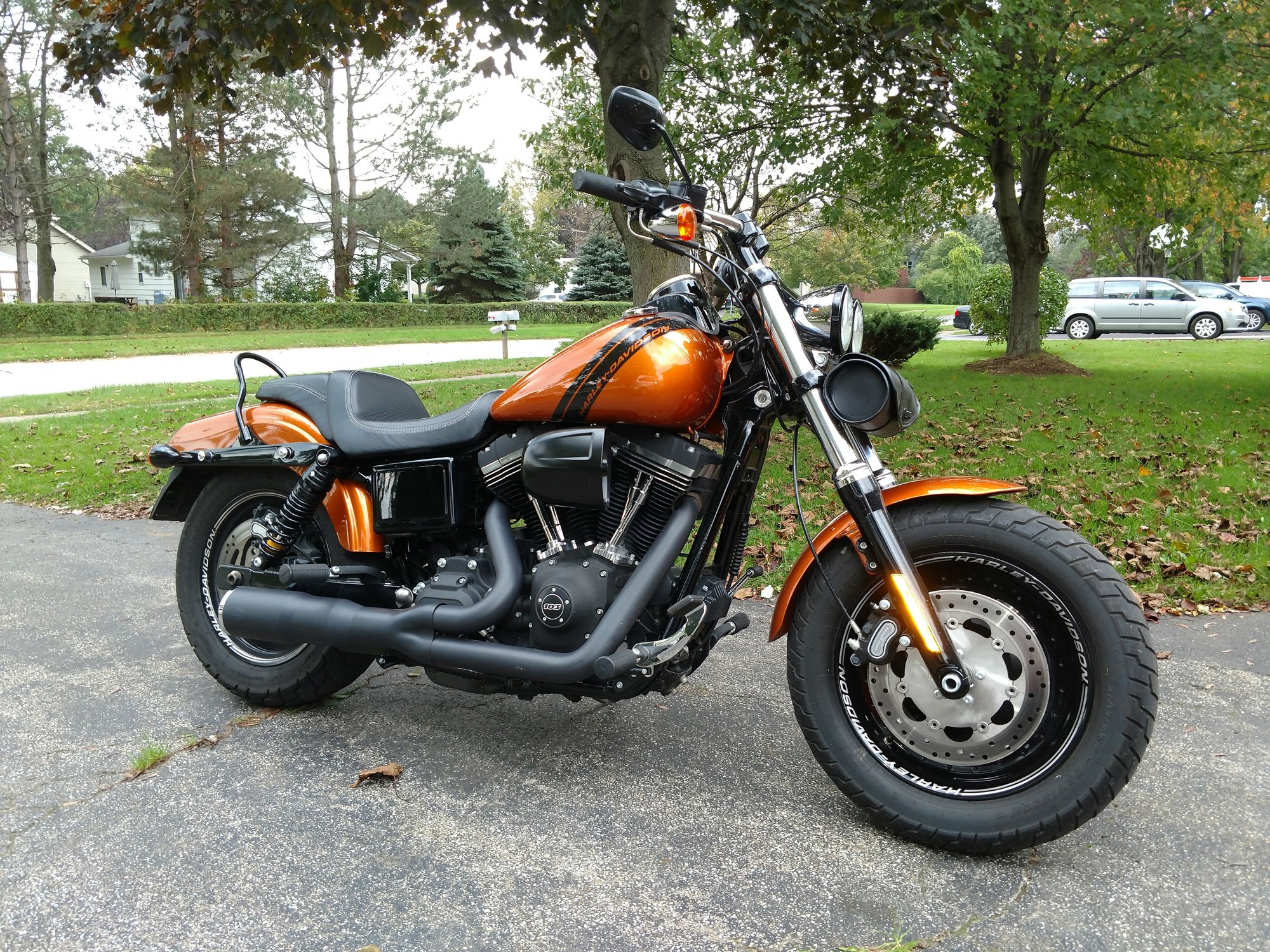

first off, congratulations man!!!
well if you're going stage one or two id suggest a good 2-1 system. In my opinion the road rage is the best for performance, though I really don't like the appearance of it. The next best exhaust is suggest is the d&d fatcat. That's what I run and I'll never switch. It's beautiful, and it sounds ****ing amazing, and it's almost as good as the road rage for performance.
As as far as cams go, I have the screamin eagle 259e, and they're great. However cams are really all about you and your riding. Do you ride aggressively, solo or two up, highway or city, do you want to stay with HD or look at other options? There's a lot of research you'll need to do to decide on cams so get on the search function and start reading everything you can.
You'll also need a good tuner. Even if you get it dyno tuned, you'll still need to buy a tuner and I would suggest Powervision from fuel moto as I suggest to everyone. If you buy pv from the dealer you'll only get 3 tunes and they're not specific for your upgrades. Fuel moto will send you a tune for your specific upgrades, then after a few autotune sessions, youll be much happier. Hope this helps

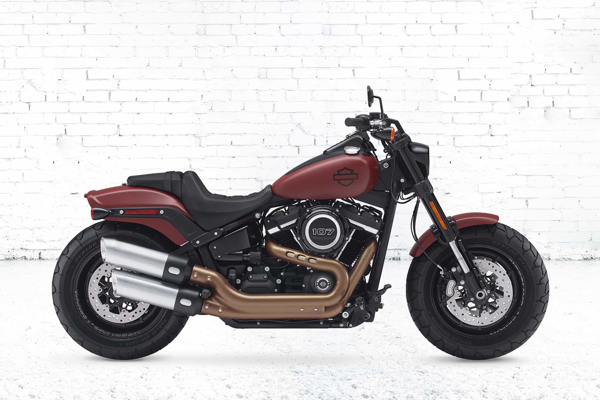

Take it back and get a 2018 fatbob. Stage 1 and 2 done + suspension upgrade done

Will need to chop 12" off your legs, tho.

further forwards.

Plenty of room for saddlebags and a passenger backrest too.
Buy a Vmax, that is not a Harley.
