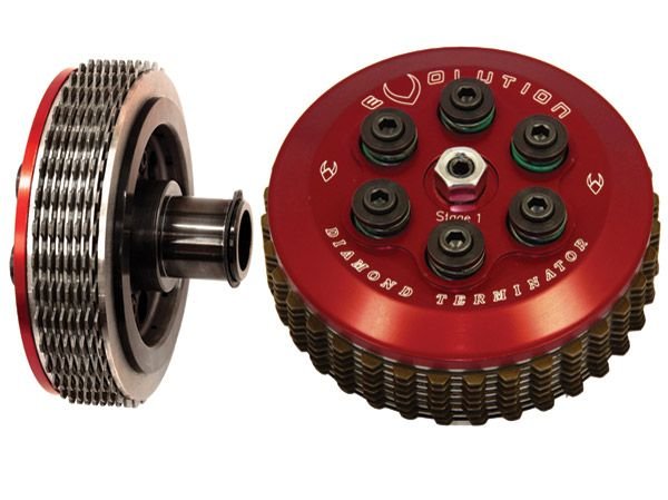

I've got an Evolution Industries Diamond Terminator clutch sitting here waiting to get installed on my LRS. Have a buddy with one in his 111" S&S powered FXR with Baker 6 speed. I was sold the first time I rode it.
