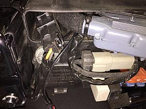

So I removed the fuse box cover and found this wedged in the top near the ECM. The wires came around the outside of the fuse box and I noticed that because of that they were pinched between the cover and the box when the cover was on. Obviously not what HD had intended.
I re-routed the wires under the seat and tie wrapped them steady. The way they were it was just a matter of time before the cover wore away the casing and created a short.
so I'm curious what this is, what it does and any ideas how it ended up wedged in the fuse box. i'm thinking some mechanic (for lack of a better word) was too lazy to properly route it when potentially the attachment was replaced.
The bike is a 2009 Lowrider FI.
Thanks,
Steve

Security system antenna. It is usually directly beneath the seat.

HD 68956-07 is a security system antenna. And yea, someone did poor install

Thanks for the replies..guess I did the right thing putting it under the seat.
