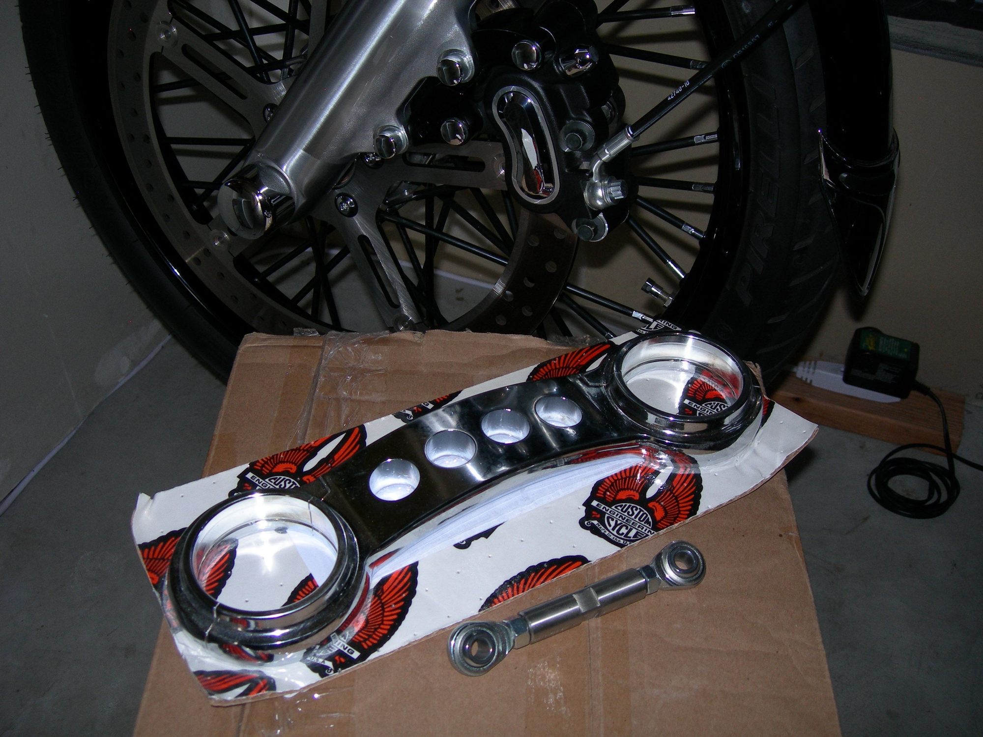

Originally Posted by rossWG
my fork extensions have just come thru customs and will arrive next week
but i think i have not thought it thru. not sure if there is enough slack in the ABS cable or brake line from the lower head manifold
fitting the arlen ness big brake kit at the same time so that may help the brake line, but not the abs cable
Check out what Cvaria has posted an image of; that might be the protective cap mounted for the active exhaust connector to plug in to and be protected from the elements. On my '13 that connector has a cap, but it's hanging loose so I've got it tucked up under the seat.
You will get some brake line slack with the Big Brake caliper adapter; it might be enough <hope!> With my non-ABS and the caliper adapter I've got enough brake line to go another 2" in fork tube length but with you being ABS that length of brake line from the manifold might be a problem.
I wasn't trying to get an image of the caliper adapter in this shot, but you can see when the brake line ends up positioned with the caliper adapter.
Keep us posted!
