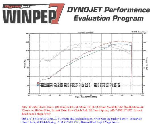

well i saw an increase across the entire range on my 110 but, my hodgepodge is not the average bear.
Hd 58mm w/4.9in vs stock.
if you want 58mm, fn do it. Dont ask for permission. .. your bike.

no argument over flow, with your knowledge on airflow and head upgrades and everything im by no means challenging you to a debate, however in my opinion, the cost of a new 58 mm (and one should upgrade to 5.3/6.0 injectors to go with it) is hard to justify since the 34% won’t equate to a 34% in power gains. Just my opinion....but I do have the 58 mm since it came with my 117 lol
We're in agreement here.
Don't forget, air velocity has as much to do with power change as the diameter. Maybe more...

Intake manifold and heads matter more than throttle body. Cvaria's chart doesn't lie but I'm not sure it tells the whole story either.
Many good street throttle bodies actually have venturi throats (narrowed section) to increase velocity without increasing pressure drop (much). Helps with throttle response.
Intake and exhaust design is amazingly complicated. Fluid dynamics, thermal dynamics, acoustics (not sound-related), etc. I'm not smart enough to understand the nuances but I know they exist.
If in doubt, try it out. Just make sure each change gets a full retune. You can always go back.

Technically you won't get 34.5% more flow unless you open up the manifold side. They are typically about 1.8 inches or about 46mm.. You still have to feed the air through that hole.. Anything above about 50-55mm, and low starts to level off.. If running 110 heads, you should see a power gain with the 58. While they can be made better, they do flow about 280-290 cfm at 28.. Stock TC 103 heads would be a waste of time. They flow 210 to 230..
